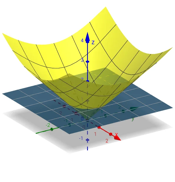

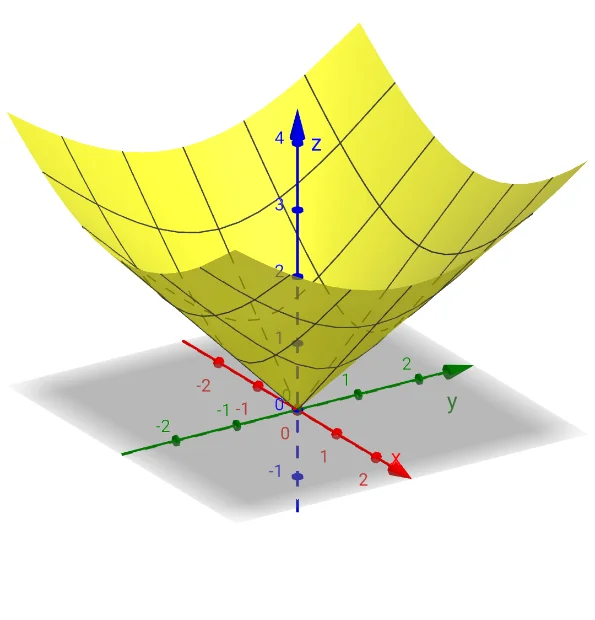

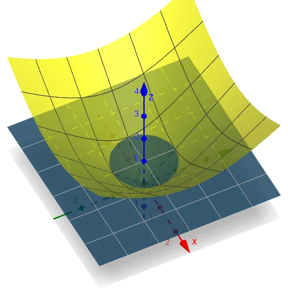

However, I already mentioned a Minkowski diagram, which the @DmitryS (and anyone else) should really draw any time he thinks he's found a paradox, because they're great at showing you where your misunderstanding was. Here's a light cone in yellow:
Time is on the vertical axis, as usual, with horizontal spatial axes. The emission event is at the origin. Now we can add a blue plane showing what this frame calls "now" a short while after the emission:
Taking a slightly higher perspective we can see that the intersection of the light cone and "now" is a circle:
Assuming that the light intensity is isotropic in this frame then it is clear that the light will have the same intensity at any angle because it's the same distance from the source.

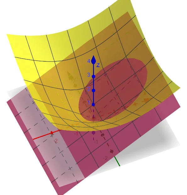

But we can instead draw a plane of constant t' (red):
Notice that the intersection is elliptical, slanted, and its center is offset from the z axis. This shows you immediately that the light cannot be isotropic in the primed frame, because you can see that some parts of the ellipse are (in the unprimed frame where light is isotropic) closer to the emission event's location than others, and will therefore see brighter light by the inverse square law.
The relativity of simultaneity strikes again.
