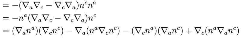

In a globally hyperbolic spacetime you have a global time ##t: M \longrightarrow \mathbf{R}## which foliates it into Cauchy surfaces ##\Sigma_t## and the metric can be written ##\mathrm{d}s^2 = -N^2 \mathrm{d}t^2 + h_{ij}(\mathrm{d}x^i + N^i \mathrm{d}t)(\mathrm{d}x^j + N^j \mathrm{d}t)##. By Gauss-Codacci the Ricci scalar ##R'## of the induced metric ##h_{ij}## satisfies ##R' = R + 2R_{ij} n^i n^j - K^2 + K^{ij}K_{ij}## and so the Einstein-Hilbert action is\begin{align*}S_{EH}[g] = \int_M \mathrm{d}^4 x \sqrt{-g} \left( R' - 2R_{ij} n^i n^j + K^2 - K^{ij}K_{ij}\right)\end{align*}This is supposed to simplify to\begin{align*}S_{EH}[g] = \int_M \mathrm{d}^4 x \sqrt{h} N \left( R' - K^2 + K^{ij}K_{ij}\right)\end{align*}how does that follow? We can write ##R_{ij}n^i n^j = {R_{ikj}}^k n^i n^j = (\nabla_i \nabla_k - \nabla_k \nabla_i) n^i n^k## and also ##K_{ab} = h^c_a \nabla_c n_b## but even when I wrote it all out it still didn't simplify nicely to the required action. The idea is to deduce the lagrangian ##\mathcal{L}_{EH}## and then evaluate the legendre transform ##\int_{\Sigma} \mathrm{d}^3 x \left( \pi^{ij} \dot{h}_{ij} - \mathcal{L}_{EH} \right)## but as it stands I can't simplify ##\mathcal{L}_{EH}##. Is there a trick I am missing? Thank you

It's just odd because I'd expected to end up with something into which you could substitute ##K_{ab} = \nabla_a n_b## and ##K = \nabla_a n^a## but instead...\begin{align*}
R_{ij}n^i n^j = {R_{ikj}}^k n^i n^j &= (\nabla_i \nabla_k - \nabla_k \nabla_i) n^i n^k \\
&= \nabla_i (n^i \nabla_k n^k + n^k \nabla_k n^i) - \nabla_k (n^i \nabla_i n^k + n^k \nabla_i n^i) \\ \\
&= (\nabla_i n^i )(\nabla_k n^k) + n^i \nabla_i \nabla_k n^k + (\nabla_i n^k)( \nabla_k n^i) + n^k \nabla_i \nabla_k n^i \\
&\quad \quad \quad - (\nabla_k n^i)(\nabla_i n^k) - n^i \nabla_k \nabla_i n^k - (\nabla_k n^k)(\nabla_i n^i) - n^k \nabla_k \nabla_i n^i \\ \\
&= n^i (\nabla_i \nabla_k n^k - \nabla_k \nabla_i n^k) + n^k (\nabla_i \nabla_k n^i - \nabla_k \nabla_i n^i) \\
&= n^i (\nabla_i \nabla_k n^k - \nabla_k \nabla_i n^k) + n^i (\nabla_k \nabla_i n^k - \nabla_i \nabla_k n^k) \\
&= 0 \quad \dots
\end{align*}which just cannot be true! So there must be a mistake :nb)

I might have overlooked something but I think the signs are correct as written; equation (3.23) of page 39 of the aforementioned notes give ##R' = R + 2R_{ij} n^i n^j - K^2 + K^{ij}K_{ij}## or rearranged as ##R = R' - 2R_{ij} n^i n^j + K^2 - K^{ij} K_{ij}##. So when substituted into the action ##\int d^4 x \sqrt{-g} R## we should have the signs as written in the OP.

It's just this part:
I don't know why it's valid to move the ##n^a## to the left side of the operator, and I also can't see how the third line follows from the second. Also, I'm not really sure what's wrong with my working in #4! :nb)

Are the indices ##a## and ##c## summed over?
Ignoring line 2, I can see how line 3 follows from line 1, although I don't know why they are writing it that way.

Yeah, the summation convention is understood. I think the second line is an unfortunate typo :smile:

Well, I don't understand if ##a## and ##c## are summed over. If you have a quantity ##T_{ij}## that is anti-symmetric, then summing over all ##i## and ##j## has to produce 0, right? Isn't the expression anti-symmetric in ##a## and ##c##?
I think that expression should evaluate to zero as in post #4 (and now that you mention it, it's indeed a contraction of a symmetric and antisymmetric part!), so I reckon they went wrong in the second line. But the mysterious thing is that their result is what's necessary to transform the integral ##\int d^4 x \sqrt{-g} R## into the one stated in Reall's notes. So I'm a bit flummoxed!
