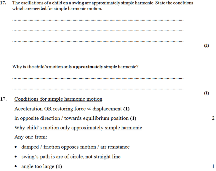

I need help for the second part please. How do the oscillations being damped prevent them from being S.H.M. as well the other 2 points? I need an explanation so I can understand. The oscillations would still have the same time period eve if they are damped.

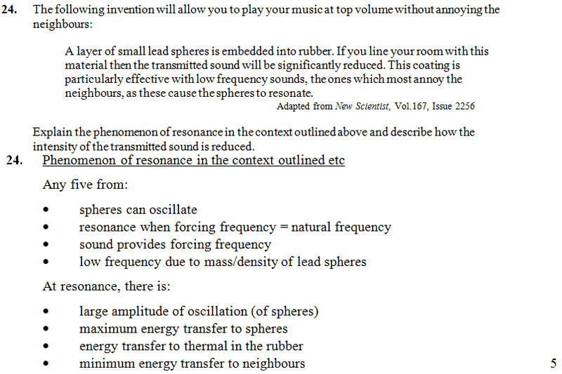

Low frequency due to mass/density (of spheres)
Can someone please explain that to me as I don't understand it.

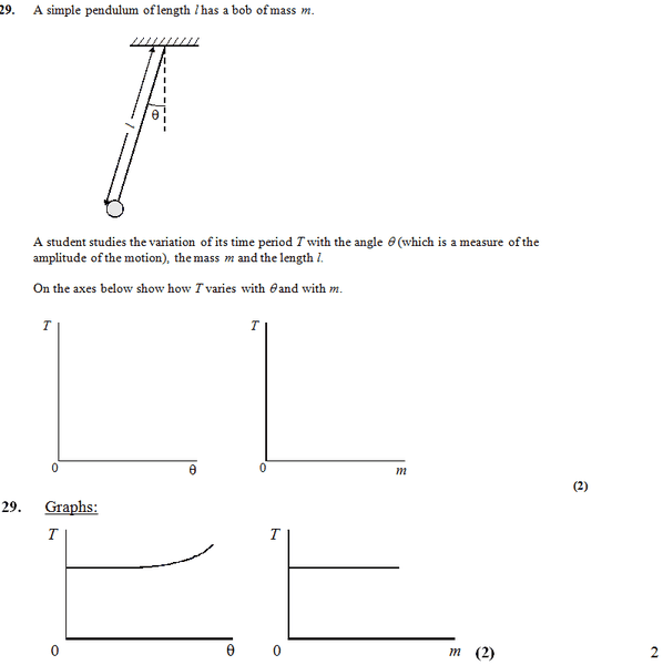

Isn't T supposed to be constant as it is independent of the amplitude theta, right?
T=2π√(m/k)
So surely as m increases T increases like the graph of y=√x?
What do the letters "S.H.M." stand for? Does this describe damped harmonic motion?
How does the mass density affect the movement?
Depends.
T=2π√(m/k)
That equation makes some assumptions about the system - what if those assumptions do not hold?
