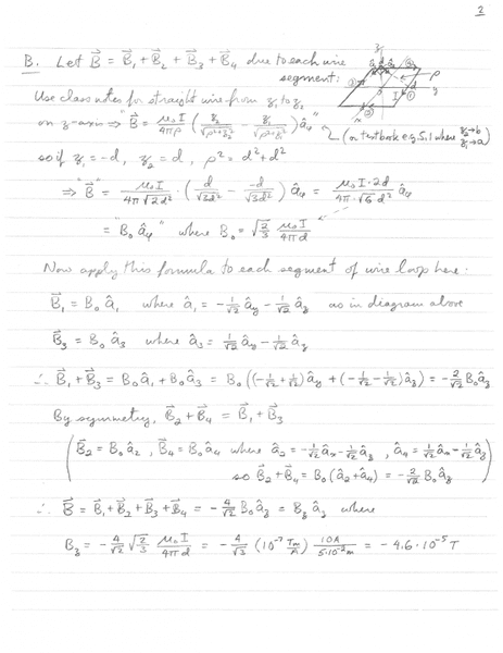

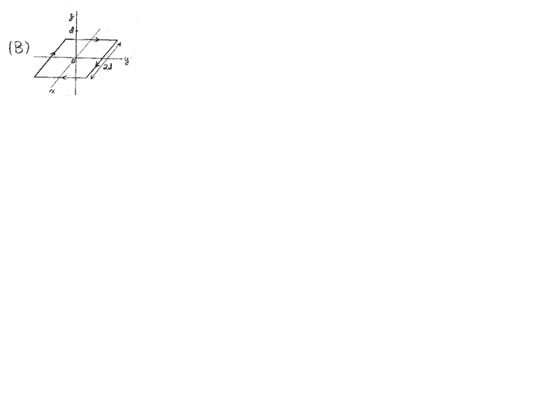

A square loop of wire in the x-y plane, centred on the origin, is made up of four straight segments, each of length 2d=10cm. A current I =10A flows in the wire in the direction shown. Find the magnetic field at z=d on the z-axis.
(See "Diagram" for the diagram of the problem)
Here is the solution provided by the professor:
(See "solution1" for the solution of the problem)
I don't understand how he came up with the expression for unite vectors a1 and a3. Could some one explain this? Thanks.
Handwritten derivation of the magnetic field from a square current loop, summing the fields of four wire segments with unit vectors a1, a2, a3, a4 and giving B3 = -4.6 x 10^-5 T.
View attachment 99110 View attachment 99111

Yes. I uploaded the pictures. You can get the pictures by clicking on the thumbnails.
