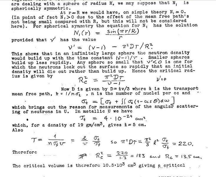

I know that the neutron diffusion coefficient D= (The transport mean free path/3), but in some documents i read that:( D=The transport mean free path*v/3) where v=The neutron number.
How is that?
Does one have an example of the latter statement?

The lectures of R.Serber, page6.

Duderstadt & Hamilton (D&H), as well as Lamarsh I believe, routinely use the approximation:
D \simeq \frac{\lambda_{tr}}{3} = \frac{1}{3\Sigma_{tr}} = \frac{1}{3(\Sigma_t - \bar{\mu}_0\Sigma_s)}
The diffusion coefficient D has units of length (cm) in those texts. It is also not uncommon to enforce, perhaps more customary units on the diffusion coefficient, D = [cm^2/s] in other scenarios. Are you certain that 'v' in that image does not mean velocity? I notice on that document, that whenever they wish to typeset \nu they handwrite it, yet in the case where they quote the value of the diffusion coefficient D, they type a letter v, leading me to believe they are distinct. I am guessing it is just the velocity (which would give units of the diffusion coefficient in [cm^2/s].

This demands the diffusion coefficient D must be in units of cm in this form, where it is noted that \phi = [cm^{-2}s^{-1}], so that each term has units of per unit volume per unit time. What I suspect is that that document uses a different definition of \phi = [cm^{-3}], as per the following: http://en.wikipedia.org/wiki/Fick's_laws_of_diffusion . In this case, it is identical to the neutron diffusion equation with the conventional definition (also in D&H) of the flux \phi furnished by definition of the neutron number density n and the velocity v (\phi = nv). With this definition, the neutron diffusion equation would be modified according to:
\frac{\partial n (\vec{r},v,t)}{\partial t} = +\nabla\cdot D \nabla n (\vec{r},v,t)} - v\Sigma_a (v) n (\vec{r},v,t) + S(\vec{r},v,t)
I do not have access to a fuller document than the photo you have attached (the link is not able to be opened for some reason). But, maybe you could verify, if you find this idea promising, the units of each term defined in the neutron diffusion equation used in that text. Make sure that \phi is really defined as it appears. Also, I hope I made sense with the arguments of each term, please feel to correct me if I am offbase.
I too was thinking along the lines of \phi = nv
and the author has decoupled n and v, so apparently assumes some average v and the transport/diffusion equation is written in neutron density. For a thermal flux where v is not spatially dependent this is OK.
But in the Primer is looks like N is the neutron density and n is the atomic/nuclear density, \phi = Nv. Also be careful not to confuse the neutron speed v with \nu (nu) = the number of neutrons produce per fission.

In the primer, critical occurs for \nu' = 0. \nu is just the number neutrons produced per fission.
The term \frac{\pi^2D\tau}{R^2} is just the leakage from the sphere in this example. As long as \nu - 1 = leakage, or \nu' = 0, the system is critical.

It is the velocity.
