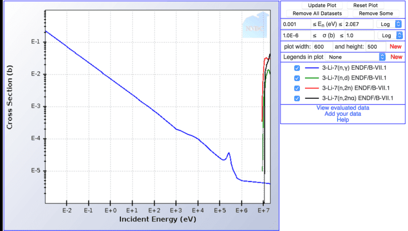

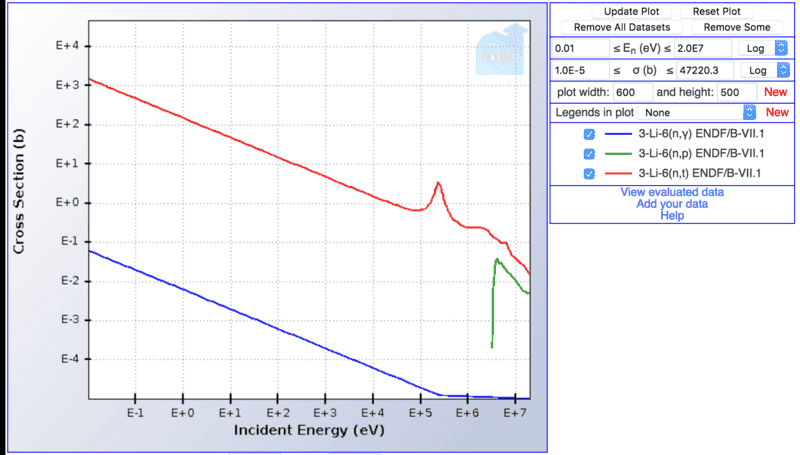

What is interesting is how to call the Li7+n or Li6+n reaction. It is not fusion but is it fission?
Technically it seems like fission as a nucleus captures a neutron then the intermediate state eventually decays after a very very short time and the end products result + extra energy.
Or is it labeled decay ?
It is called fission, when the two products are more or less of equal size, e.g., n+6Li -> α +t, or spallation, when other smaller particles are emitted, e.g, (n,2n) reactions. Some reactions have high threshold energies, and some are very unlikely (low cross-section) compare to the main reaction.
