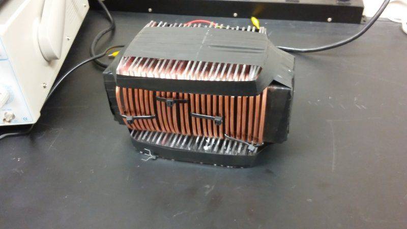

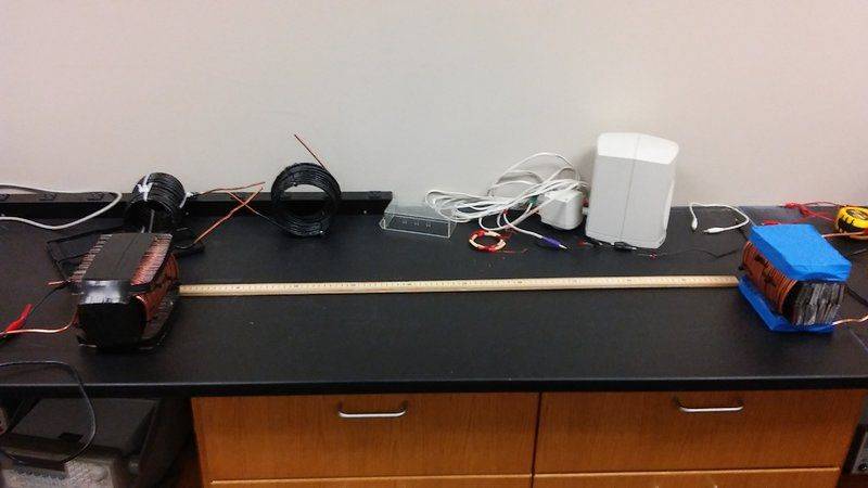

I have these two very large (ferrous core) coils,
They are basically identical, each 200mm long and have a diameter of 100mm. The core is medium grade steel
One coil is receiving an input of 8V(peak-to-peak) @ 4 MHz from the function generator. The second coil is placed 1m away, and is connected only to an oscilloscope where it showing 20mV(peak-to-peak) while the transmitting coil is operating. My question is this: when I bring the palms of my hands close to the poles of the transmitting coil I get an increase of up to 40mV(peak-to-peak) measured voltage on the secondary coil. What effect is the close proximity of my body having on the poles of the primary coil?
I think it is happening because of the increase in magnetic permeability of the medium, which is increasing the magnetic coupling between the coils.

How about Capacitative Coupling, plus the imbalance in the feeds to the coils? Once you look in detail at this sort of arrangement, its equivalent circuit is far from the original circuit that's sketched on the first fag packet during your planning.
To get near to the theoretical situation, you need a Balun at each end to convert the unbalanced source and receiver into balanced feeds. That will take care of a lot of problems.

That's for the optimum coupling. A parasitic Capacitance can produce noticeable effects way off resonance. 4MHz is very much 'RF' and needs to be treated with more respect (Impedancewise) than audio or Mains.
At 4 mhz
a lone picofarad is about 40 kilo-ohms.
so capacitance between your coils is significant at that frequency.
Try holding the 'scope probe at various places along your yardstick, perhaps with a 1" square aluminum foil 'capacitive pickup'.
Then try it again with a few turns of small wire on maybe an inch diameter for a 'magnetic pickup' . https://en.wikipedia.org/wiki/Body_capacitance
Capacitance of a human body in normal surroundings is typically in the tens to low hundreds of picofarads, which is small by typical electronic standards. While humans are much larger than typical electronic components, they are also mostly separated by significant distance from other conductive objects. Although the occasional static shock can be startling and even unpleasant, the amount of stored energy is relatively low, and won't harm a healthy person. The Human Body Model for capacitance, as defined by the Electrostatic Discharge Association (ESDA) is a 100pF capacitor in series with a 1.5 resistor[1]

+1 to what Jim said. Is the 20mv signal a real signal transmitted between the coils or just pickup in the scope via the power supply or some other route.
To dispel some theories: When the primary coil has no input the secondary coil registers no output. Furthermore, as the input voltage is increased in the primary coil voltage output increases in the secondary coil.
Conductivity between coils: There is no contact between the coils, or interfering metals either on my person or the table (which is made of an non-conductive epoxy).
Balancing: I set up chokes to substitute for baluns, this increased the range of the primary coil at either pole, so that the secondary coil could withstand some pretty major misalignments, but it did not increase the maximum magnitude of the voltage in the secondary coil. Which makes sense I guess.
Coil Physical Properties: The copper conductor is 6 AWG (diameter = 4.115 mm) and 7.25 m long (uncoiled). The core is from a company called Everbilt, I was informed by the manufacturer that it was made from a mixture of two low-carbon "mild" steels, typically sold as flat bar for welding. I was told that company specs define the permeability as between 1.25 *10^-5 and 1.25 *10^-4 Henries/meter, and relative permeability estimated between 10 and 100.

. . . . which is why I said that the measurements must be balanced, to eliminate the effects of any unbalanced induced voltages. (There will be very little balanced voltage coupling). Off the shelf centre tapped transformers (Baluns) could produce a great improvement in balance. You can obtain kits for winding your own TXformer with ratios of your choice. A 4MHz Balun cannot be that hard to wind yourself.
There are a number of approaches to trouble shoot this.
If you observe the supply and output signal waveforms, synced to the input signal, I expect that the phase between the two waveforms can be seen to change noticeably as you wave your hands about.
Alternatively, you can reduce the effect of electric fields by loading the secondary coil with a lowish resistor.
You could do the experiment over a large Earth plane and take the signal leads through holes in the plane.
