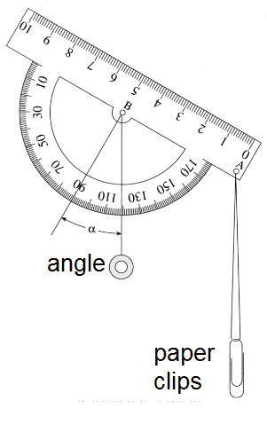

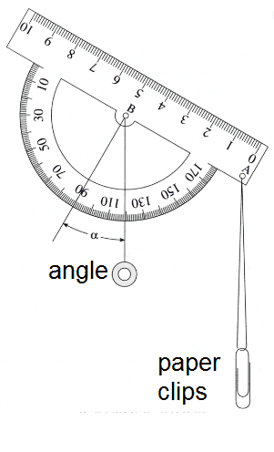

Yesterday, our physics class had a laboratory examination, in which we used a protractor as a "weight".
We hung some paperclips and checked the angle.
Then, they asked about the physical meaning of the slope of the graph: tan( angle) as a function of n( number of paperclips). The relation is linear.
The slope has no dimensions, as you can see.
Unsatisfied with the teacher's answer, which had mathematical meaning, I persisted to find the physical meaning. A slope can not be just a random value, it must be consisted of some constants.
So, my intuition is that the slope is the ratio between the mass of a single paperclip and the mass of the counter side of the protractor.
This is due to the fact that the bigger the mass of the paperclip is, the greater tan( angle) would be, so the mass must appear in the slope.
I tried to prove it, or to find a general relation between the tan and n, but with no success.
I would like to hear your ideas of what the slope could be.
Thanks.
Have you considered the torque about point B?
Actually, I have. But, I couldn't find the relation.
think about protractor's center of mass

What did you get? Your intuition above gave you the right answer, but you should be able to derive it mathematically. It's pretty straightforward.

I guess I shouldn't have said it was the right answer, but you're right that it depends on the ratio of the masses.
You actually have been given hints already: consider torques and the protractor's center of mass. Take a stab at it and tell us what you come up with.

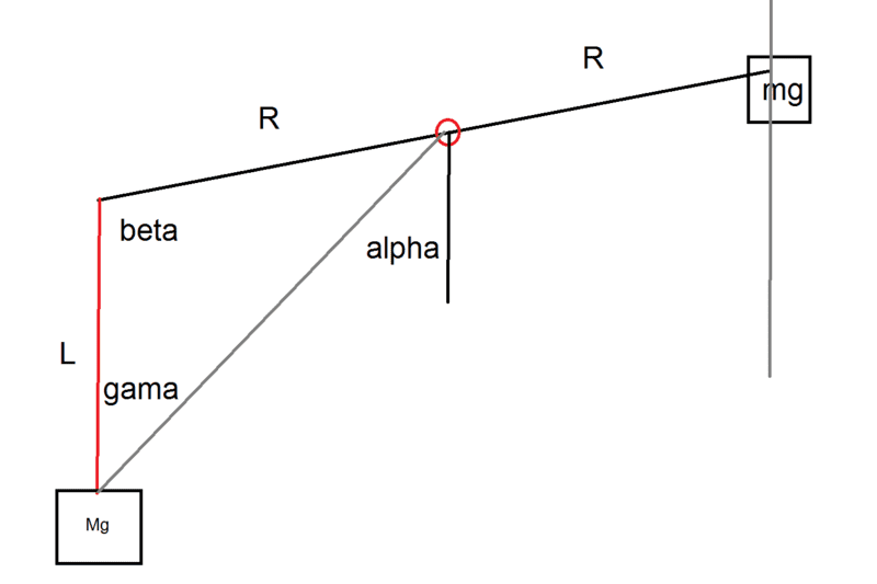

This is my attemp:
M- the mass of paperclips
m-the counter mass
l- the lengh of the rope
r- the half lengh of the protractor
The system will rest when the torques are zero.
τ1=τ2
√(r^2+l^2-2rlcos β) * Mg* sinγ= mg* r *sin β
sin γ= r*√(r^2+l^2-2rlcos β) /sin β by sine theorem
therefore:
(r^2+l^2-2rlcos β)* M /sin β = m sin β
α=180-β between the r and the vertical axis
(r^2+l^2-2rlcos β)*M = m sin^2 β
r^2*M+l^2*M-m = -cos^2 α *m -2rlcos α *M
Here, I tried to solve a quadratic equation with refernce to cos α, and divide √1-cos^2 α by the result to get tanα, but as you might expect, it is too complex...
Have I made a wrong assumption?

That should be ##\frac{\sin\gamma}{r} = \frac{\sin \beta}{\sqrt{r^2+l^2-2rl\cos\beta}}##. In your expression, the lefthand side is unitless where as the righthand side has units of length squared, so it can't be right. Anyway, if you work that last step out correctly, you'd get some cancellation and end up with ##Mgr\sin\beta##. You could have gotten to this expression directly from using the fact that the torque is equal to the force times the distance from the pivot point to the line of action of the force.
There's a problem with the other side of the equation. (By counter mass, I assume you're referring to the mass of the protractor.) Imagine the protractor is horizontal and there are no paper clips so that any net torque is only due to the protractor's mass. The way you defined the angles, you'd have ##\beta = 90^\circ## and ##mgr\sin\beta \ne 0##. In other words, there'd be a torque on the protractor causing it to rotate. Is that what you'd expect? Where is the center of mass of the protractor?

I do not understand the diagram in post 14. In the OP you wrote
In the diagram in the OP, where is the pivot? I assumed it was at B, but if so, what is that ring suspended from point B? Is that supposed to represent the weight of the protractor? I suggest it would be a bit further to the left, otherwise no balance would be achieved.
