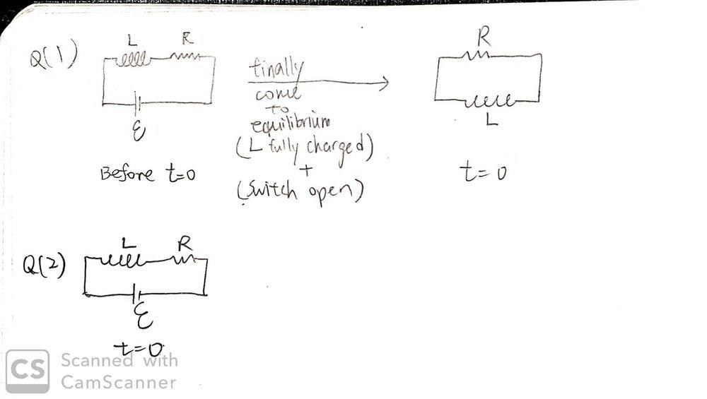

For (1), is there a diagram for the circuit in question?
If it is purely a series circuit and an inline switch is opened, where's the closed circuit to allow current to flow once that switch is opened?

There's no diagrams provided in both Question (1) and (2), but I could draw the diagrams from my own understanding. (See attachment)
The descriptions in the Homework Statement aren’t quite correct. I think this is intended:
https://s3-us-west-2.amazonaws.com/...ites/222/2014/12/20110934/Figure_24_10_01.jpg
(from https://courses.lumenlearning.com/physics/chapter/23-10-rl-circuits/)
For Q1, switch is in position 1, circuit reaches equilibrium. At t=0 switch is changed to position 2.
For Q2, switch is in position 2, circuit reaches equilibrium. At t=0 switch is changed to position 1.

hidemi said:
Thanks for the response!
I think your diagrams make more sense.
If those are the cases, then do my thoughts on post#1 still remain valid?
Your explanation for Q1 is OK but (being picky) rather than say
“the potential difference across the resistor will be close to 0.“
I would say something like
“the potential difference across the resistor decays exponentially (tending to zero for large times)”
For Q2 you said
“thus voltage is at its maximum (because the inductance has a maximum reactance in the beginning)”.
That's wrong.
You can’t use the term ‘reactance’ here because the concept of reactance is used for alternating current flowing through an inductor (inductive reactance ##X_L = 2\pi f L## wherre ##f## is the frequency).
I would say somethng like:
“thus emf is at its maximum (because the current is changing fastest at the beginning and induced emf is proportional to rate of change of current)”
