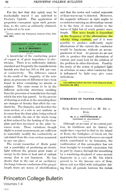

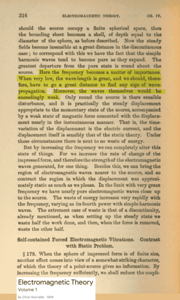

The following sources confused me in a way since I didn't read them properly. I had assumed that they understood that energy of electromagnetic waves had to do with frequency or wavelength.
The energy of a single photon is proportional to the frequency. However, a beam of light has a variable number of photons, so the energy of the beam is not necessarily proportional the frequency.
It is like the difference between how hard it is raining and the size of a single raindrop.
