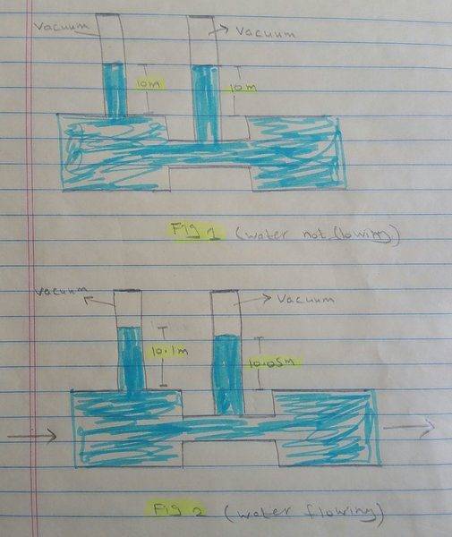

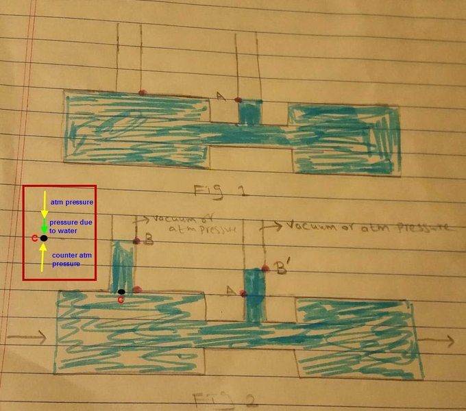

Please have a look on the attachment. In Fig 1 the water is stationary and has an equal level all along. As they say that water seeks its own level and the reason for this is the fluid pressure due to gravity.
In Fig 2 the water is flowing from left to right. The height of column water in the tubes vary which represents pressure differential because of varying speeds.
Is the height of water in the tubes affected by whether the tubes are exposed to atmospheric pressure or have vacuum?
I believe that it does matter. The atmospheric pressure finds its way everywhere even in underground water reservoirs. The flowing water in the pipe is already affected by atmospheric pressure. Therefore, the pressure at point C is only due to the weight of column of water and the atmospheric pressure gets canceled with each other. Please see Fig 2.
The water in a column is raised to almost 10 m height by atmospheric pressure therefore when the tubes have a vacuum, their height should be enough to compensate for 10 m height plus additional increase in height due to the pressure of flowing water.
Thank you.
If you increase the pressure of both tubes by 1 atmosphere and the pressure in the water at all points by 1 atmosphere, why would you expect anything to change?

I don't understand your statement but I see that my own wording was confusing in previous post so let me elaborate.
The atmospheric pressure finds its way everywhere around us even in deep underground water reservoirs. I'm saying this because one could think that water in the pipe is not affected by atmospheric pressure as if the atmospheric pressure cannot 'penetrate' inside the pipe.
I'm considering a case when the tubes are sealed at top and have vacuum. In such a case when the water is not flowing the height of column of water in those tubes would be almost 10 m. Because as I said that atmospheric pressure finds its way everywhere therefore the water inside a pipe is pressed by atmospheric pressure and it gets raised to the height of 10 m in both tubes.
A flowing fluid has its own pressure and is a function of fluid's speed along its path of flow as stated by Bernoulli's principle so when the water starts flowing, it exerts more pressure in region with larger cross section compared to smaller cross-sectional region. Let's assume that in larger cross-sectional region this 'flowing water' pressure is equivalent to 0.1 m height of column of water therefore total height of column of water in that region would be 10m+0.1m=10.1 m. Likewise, the smaller cross-sectional region could be assumed to have 'flowing water' pressure equivalent to 0.05 m height of column of water therefore total height of column of water in that region is 10m+0.05m=10.05 m. Do I have it right? Thanks a lot.

"Flowing water pressure" is negative.
We could speculate that the water is flowing from a large reservoir on the left which is maintained at atmospheric pressure and flowing into a large reservoir on the right which is also maintained at atmospheric pressure. We could neglect the viscosity of water so that the flow can be maintained by a negligible pressure difference between the two reservoir.
Given that setup, the pressure in the wide pipe section under the left vacuum tower will be slightly less than atmospheric pressure. Bernoulli's principle tells us that this must be so. We might choose a flow rate and pipe diameter so that this pressure is "50 cm H20" less than atmospheric pressure. Similarly, we might choose a pipe diameter so that this same flow rate gives a pressure under the right hand vacuum tower that is "100 cm H20" less than atmospheric pressure.
In this case, the water height in the left column would be 50cm less than the nominal 10 meters and the water height in the right column would be 100 cm less.
Does that answer the question you were trying to ask?

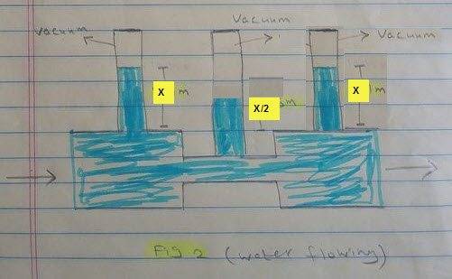

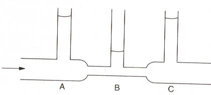

Let's have a look at it again considering the setup from post #4 but assuming that there is no atmosphere and hence no atmospheric pressure. We can assume that a pump is pushing water from one reservoir to another reservoir. The water is flowing with a certain flow rate and both reservoirs are the same level. In the far left and right towers water would be at the same height and in the middle tower it would be at half the height. Difference in height signifies pressure differential and I believe that this is 'dynamic' pressure. Am I right? Thanks a lot for your help.
Thank you.

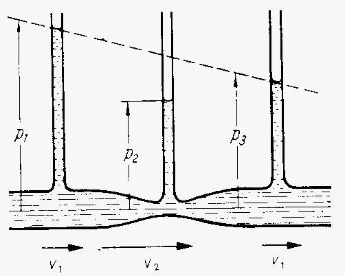

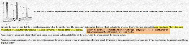

This is the first time I have seen that the height varies along the pipe in areas even with the same cross section. This is the mostly encountered depiction. But it looks like that there is contradictory statement and wanted to verify with you. I was using Google translate. Doesn't the highlighted statement contradict the height shown for pipe 1 and pipe 3 in the figure on left because the height varies for both which means different hydrostatic pressure? Thanks for your help.
The sentence means that the hydrostatic pressure in pipe 1 and pipe 3 is the same as in the reference case:

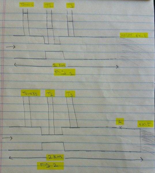

Everything is kept the same other the length of pipe in this setup. The water enters from the left and exit on the right end. In Fig. 1 the length of pipe is 1 km and in Fig. 2 it is 2 km. Do you think that the length of pipe would affect the height of water column in Tower 1, Tower 2 and Tower 3 in Fig. 2?
Moreover, in my book the Bernoulli's equation is given as P1 + ½ ρv₁^2 + ρgh₁ = P2 + ½ ρv₂^2 + ρgh₂ where P1 and P2 are pressure. If h₁ and h₂ are the same then the factors ρgh can be neglected. In the view of this equation, I don't see why the height of p1 and p3 in this picture should differ. Could you please guide me? Thanks.

PainterGuy said:
Moreover, in my book the Bernoulli's equation is given as P1 + ½ ρv₁^2 + ρgh₁ = P2 + ½ ρv₂^2 + ρgh₂ where P1 and P2 are pressure. If h₁ and h₂ are the same then the factors ρgh can be neglected. In the view of this equation, I don't see why the height of p1 and p2 in this picture should differ. Could you please guide me? Thanks.
https://en.wikipedia.org/wiki/Bernoulli's_principle:
"The following assumptions must be met for this Bernoulli equation to apply:[9]
  • the flow must be steady, i.e. the fluid velocity at a point cannot change with time,
  • the flow must be incompressible – even though pressure varies, the density must remain constant along a streamline;
  • friction by viscous forces has to be negligible."
Can you think of an assumption above which is not always realistic?

But in this setup do you think that the length of pipe would affect the height of water column in Tower 1, Tower 2 and Tower 3 in Fig. 2? Everything is kept the same other the length of pipe in this setup. The water enters from the left and exit on the right end. In Fig. 1 the length of pipe is 1 km and in Fig. 2 it is 2 km.
I do understand that if the location of Tower 3 is moved to point A in Fig 2, there will be be further decrease in the height. Thanks.
PainterGuy said:
All of those three assumptions are ideal.
Right. In real life, one or all of them may be violated. The effects of the violation may or may not be negligible. It depends on how much error you are willing to neglect.
It depends on how much error you are willing to neglect. And pipe diameter. And pipe length. And flow rate.

In both cases, Fig 1 and Fig 2, error tolerance is the same. Also the pipe diameter and flow rate is the same in both cases. The only difference is length - in Fig 1 it's 1 km and in Fig 2 it's 2 km. In comparative terms, would it affect the height of water column in Tower 1, Tower 2 and Tower 3 in Fig. 2 compared to Fig 1? Thank you.
There is no way to know from the limited information that you have provided.
Given the flow rate that you have not specified, the pipe diameter that you have not specified and the viscosity of water which you can look up, how much pressure drop would the Poiseuille equation call for?
https://en.wikipedia.org/wiki/Hagen–Poiseuille_equation

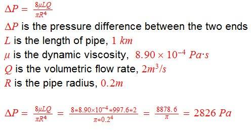

The Hagen–Poiseuille equation is ΔP=(8μLQ)/(πR⁴) and ΔP is is the pressure difference between the two ends. I think that "the two ends" don't refer to the two ends of pipe. Could ΔP be defined as the pressure difference between two points along the pipe? Thanks.
Yes.
You seem strangely resistant to providing numbers or doing calculations. Say you drop three diameters off of each end of your one kilometer pipe. Can you apply Poiseuille's equation to that length?
Thank you.
Is it okay? Please let me know. Thanks.
