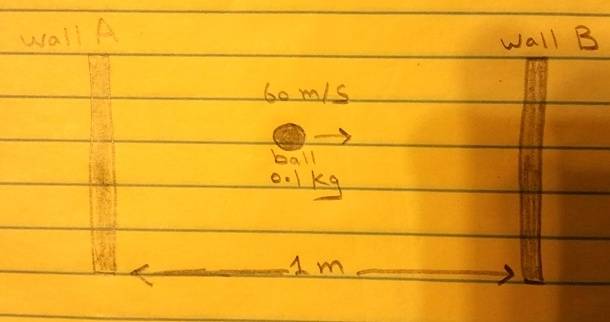

Please have a look on the attachment. Suppose that a 0.1 kg rubber ball having velocity of 60 m/s is moving between two walls A and B, and the distance between the walls is 1 m. It is having elastic collisions with the walls.
Let's focus on what is happening at wall B. The ball is moving toward wall B. The momentum of ball is 0.1 x 60 = 6 kgm/s. It strikes wall B, has elastic collision, and reflects back and starts traveling toward wall A. Let's assume that it spends an infinitesimal time, dt=10-3s, during the collision. The force exerted by the wall on ball is F=(mv-mu)/dt=(-6-6)/10^-3=-12000 N. The force exerted by the ball on wall B is 12000 N.
After having a collision with wall B, the ball starts traveling toward wall A and it would cover a distance of 2 m before it has another collision with wall B. It will take almost 0.034 seconds to strike wall B again and the frequency of collisions with wall B is 30 collisions per second. The average force might measure almost 12000 N or little less than that on some sensor placed at wall B while this process of the ball movement between two walls continues.
Do you agree with what I'm saying above? Thank you for the help.
There is no need to guess about the average force; you gave us the time of and between collissions.

I believe that I understand what you are saying. Let's assume that the force sensor is an analog one. When the first collision happens, the sensor will read 12000 N but as soon as the ball starts traveling toward wall A, the sensor needle will start falling toward 0 N and the falling movement will continue until another collision occurs but if the frequency of collisions is high enough the needle won't have enough to move much from the mark of 12000 N.

Again: you are guessing based on the functionality of a hypothetical force sensor. Again: you gave us the times, so there is no need to guess. Calculate!
There is no need to assume that the ball spends an infinitesimal time during the collision (Edit: regarding the pressure exerted on walls by an ideal gas)!
The ball moves horizontally with speed |vx| back and forth between two walls, which are a distance L apart. When it hits the right wall and bounces back, its momentum changes by Δpball = -2m|vx| (here, m is the ball's mass). As the time interval between successive hits on the right wall is Δt = 2L/|vx|, the average force the wall exerts on then ball is Fball = Δpball/Δt = -mvx2/L. The average force that the ball exerts on the wall is thus Fwall = mvx2/L.

Let me try.
Total time spent during 30 collisions is 30x10^-3=0.03s, and the ball exerts 0 N force during 0.97 s. I believe that the average force should be almost 360 N. Please let me know if I have it correct. Thanks.

Your comment was on point. Now I understand that the force used in kinetic theory of ideal gases is an average force.

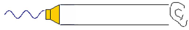

Yes, the statement "a sound wave can therefore never travel faster than the average speed of the molecules" is correct but it's not complete. It does make sense that a sound wave cannot travel faster than the average speed of molecules but it can still travel at the average speed of molecules.For some time I did agree with the statement "I think it is because the molecules have both an average speed and an average direction. In essence, means the sound is zig-zagging toward you" but later observed that it needs more explanation.
Suppose that we could draw all the arrows possible from the center of unit sphere toward its surface. There would be an infinite number of such arrows and each arrow represents a direction. Each of the air molecule could have any direction and like the arrows of unit sphere the number of such directions is infinite, and the direction of each molecule gets changed continuously as a result of collisions with other molecules.
To begin with, in my humble opinion, I don't think that there is an average direction. I think if we could add up the velocities of all molecules, the resultant velocity would be zero. I believe that I might be misinterpreting the use of word "average direction" above.Please have a look on the attached image. Please also have a look on longitudinal wave motion on the following page: http://www.edu.pe.ca/gray/class_pages/krcutcliffe/physics521/14waves/applets/Longitudinal%20and%20Transverse%20Wave%20Motion.htm#longitudinal. The air molecules in the pipe are moving with average speed of 450 m/s (1620 km/h or 1007 miles/h) in all possible directions. As the speaker moves, it imparts momentum to the right and right of screen (momentum imparted toward the right in case of compression and toward the left in case of rarefaction). I hope that I have it right. Please have a look on the attached image. The horizontal and vertical components of projectile motion are independent of each other. Likewise, the momentum imparted by speaker to the air molecules is independent of their random motion and therefore zig-zagging shouldn't affect the speed of sound. I mean that if the speaker is imparting concerted velocity of 2 m/s toward the right of screen then the molecules should be able to transfer this velocity thru their collisions with each other with their average speed, i.e. 450 m/s.In post #16, Prego Principle was mentioned. What is it? Thank you.
  • Diagram of a sound wave travelling from a loudspeaker-like cone on the left through a long tube to an ear drawn on the right, with a wavy line representing the wave.

Could you please comment on the post above? Thank you.
The speed of sound must be somewhat less than the “average” molecular speed because not all molecules are moving in exactly the same direction as the sound wave.
