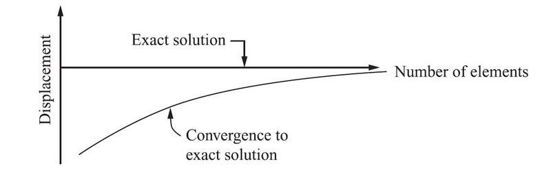

What the OP meant is that FEM always converges from below (displacements and stresses increase with mesh refinement). This is proven in the aforementioned books, based on strain energy which is always underestimated in FEM.

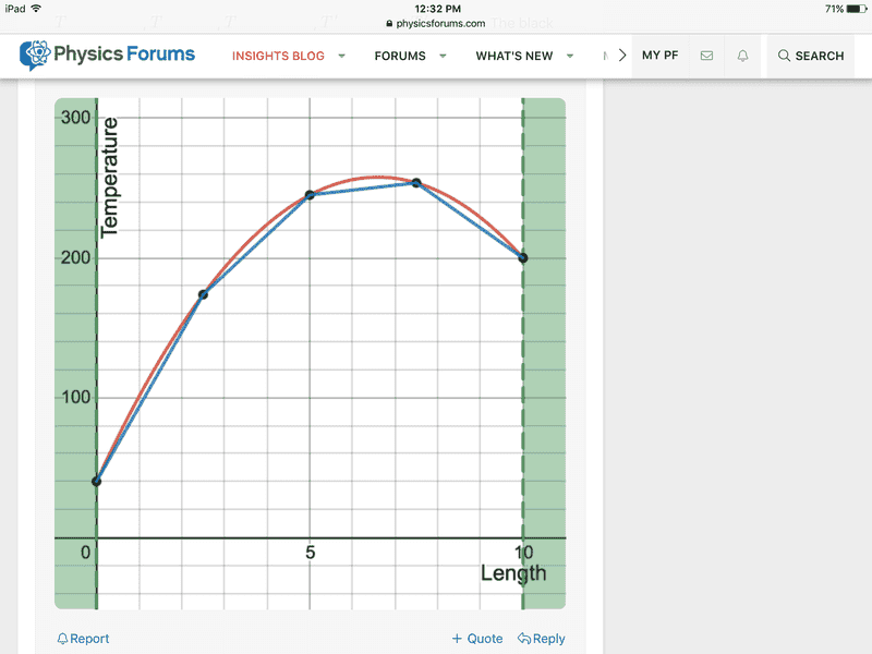

Like this simple example of a 1D temperature profile of a rod of length 10 units where the red is the analytic solution, the points are the FEM numerical solution and the lines are the linear interpolations between the node values?
Not really, such graphs are in fact commonly used to illustrate the concept of discretization. The plot showing what we discuss here (convergence from below) may look like this (from "A First Course in the Finite Element Method" by Logan):

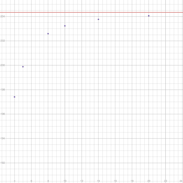

If I pick one point on my curve and plot the extrapolated solution vs. the number of elements used I get this where the red line is the exact value and the points are the extrapolated values between the node points for different numbers of elements;

many thanks really helpful, though it's not explained 100%, for all it says is that the solution is underestimated without saying why.
I didn't have time to go through the whole section carefully but I think that the explanation lies in the equations presented there and the text that you are talking about is just a comment to these equations.
