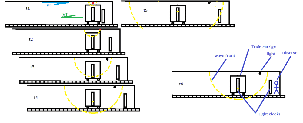

as explained before there is a train in a large building, 2 light clocks in the large building (LB) to, 1 in the train the other at rest wrt the building
the building and everything in it is whizzing thru space at some velocity V in some direction V
there is a strobe light in the roof
the train heads off along the tracks. Purely by chance the tracks are parallel to the direction of travel of the LB
The train heads off and attains a steady velocity. Purely by chance the velocity of the train is exactly the same as that of the LB , but in the opposite direction
we end up with the situation as depicted.
Purely by chance the strobe light in the roof strobes at the instant the train is directly below the light
once a photon enters a light tube it is reflected up and down
an observer in the frame will see the train whizzing away from them and the light clock in the train will be perceived by the observer to be ticking slower than the clock at rest wrt the observer
as before pulses are sent back along the train lines
will the train line pulses tick faster than the clock at rest wrt the observer
I have drawn the successive events one under another
  • #70
RossBlenkinsop said:
can you tell me what is wrong with my logic
This picture shows the light propagating at speed ##c## using the frame in which the railcar is at rest, but not using the frame in which the strobe light and other stuff is at rest. Take another careful look at post #29 of this thread by @Janus and also try drawing a Minkowski diagram instead of trying to represent the passage of time as a series of still pictures.
I also think that you may be overlooking the relativity of simultaneity here. That’s another good google search.
  • #71

Here are a couple of spacetime diagrams. These are essentially displacement-versus-time diagrams, except that conventionally time is shown up the page and position horizontally. Also, the scale is picked to be seconds and light seconds, so that the speed of light (one light second per second) gives the paths followed by light a slope of ##\pm 1##.
Apologies for the hand-sketching. All lines are meant to be straight. I can draw computer-generated versions at the weekend if it helps.
Here is the first diagram:
In this diagram there is one observer, marked in red, stationary at the origin. A second observer, marked in blue, passes by moving to the right. At the instant they pass, a flash of light is emitted, marked in fine orange lines. Because the slope of these lines is ##\pm 1##, the midpoint ("where the flash was emitted") is always where the red observer is. The blue observer is to the right of this at all times after the actual emission event.
Here's the same scenario in the blue observer's rest frame:
Now the blue observer is stationary at the origin and the red observer approaches moving to the left. Again the flashes are emitted when the observers pass, but this time the midpoint of the flashes is where the blue observer is.
So in both cases "where the flash was emitted" is the origin of the spatial coordinates (##x=0## in one case, ##x'=0## in the other). But it's clear that the two frames mean different things by this - ##x=0## is where the red observer is and ##x'=0## is where the blue observer is. And they are not in the same place.
If, as @Nugatory has suggested a couple of times, you actually mean that "the flash happens when and where the observers pass one another" then everyone will agree. But this is an event (a place and time), not a point. A point in space has multiple different meanings depending on which frame is doing the describing.
