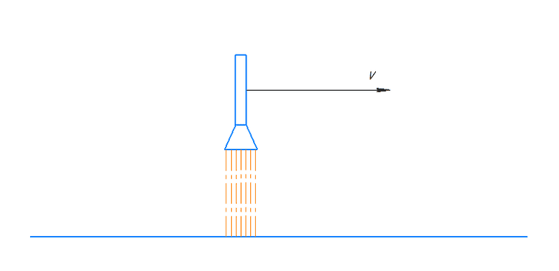

As I understand it, there is no difference at which point of the photocell the flashlight shines during its movement, since the process in the photocell takes place at the speed of light, the maximum possible and constant for any reference frame.
Dale said:
I see in the OP that you have a diagram showing circular motion, but I thought you were interested in inertial motion, so please clarify.
I assumed that the transition from a straight line to a circular motion would be possible. As I wrote above, it is stated in the literature that circular motion during the operation of the Faraday disk does not prevent the application of the provisions of the special theory of relativity to processes in the disk. To simplify the discussion, I proposed a model with rectilinear motion, but of course, I would be very grateful if you would comment on the model for circular motion - if the rails are enclosed in a circle and the capsule moves in a circle relative to the rail.

Ivan Nikiforov said:
View attachment 356754 As I understand it, there is no difference at which point of the photocell the flashlight shines during its movement, since the process in the photocell takes place at the speed of light, the maximum possible and constant for any reference frame.
Ah, ok, that diagram clarifies. I thought this was a 1D problem. I see that it is a 2D problem. The geometry was not what I was envisioning at all.
This is a tractable problem. The additional difficulty from having a 2D problem is minimal.
The velocity-arrow at the flashlight in your drawing suggests, that the angle between the light-direction and the velocity-direction is 90° in the restframe of the photocell. This angle is frame-dependent (aberration, see i.e. light clock).
Then the light-energy in the restframe of the photocell is smaller by the factor ##1/\gamma## than in the restframe of the flashlight (=redshift).
However, if the angle between the light-direction and the velocity-direction would be 90° in the restframe of the flashlight, then the light-energy in the restframe of the photocell would be bigger by the factor ##\gamma## than in the restframe of the flashlight (=blueshift).
Reply

Sagittarius A-Star said:
if the angle between the light-direction and the velocity-direction would be 90° in the restframe of the flashlight, then the light-energy in the restframe of the photocell would be bigger by the factor γ than in the restframe of the flashlight (blueshift).
@Ivan Nikiforov note that this is what I assumed and this was indeed the result that I found.
