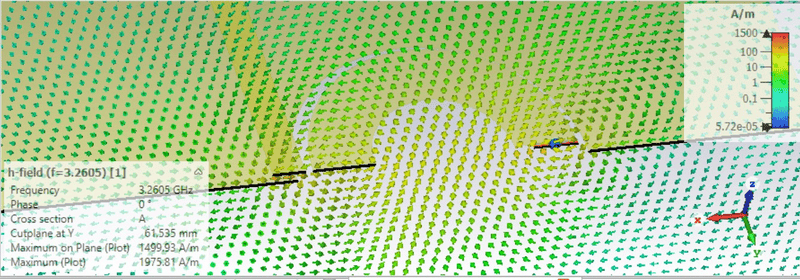

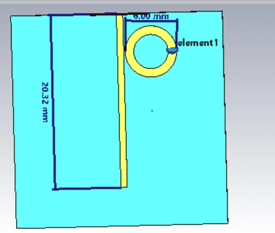

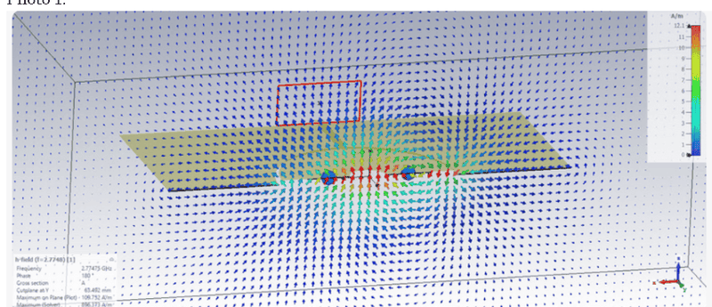

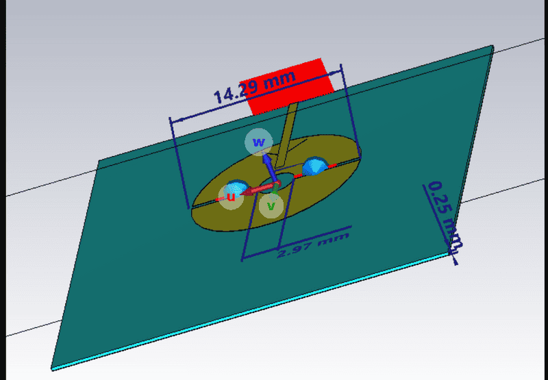

Hello ,I have built a resonator in CST as shown bellow .
I need to make the resonator be in such mode so the H-field will be normal to PCB plane.(W diection in the photo).
Surface shows two peaks.
As you can see I have peak magnetic field at the edges.
Is there some PCB way to excite magnetic field peak in the middle of the ring in the direction of W(normal to PCB plane)?
Thanks.
Is there a ground plane ?
A ground plane would define the electric, not the magnetic field to be vertical.
To excite and maintain a circulating current in the ring, you would need to remove the ground plane below the ring, so that the magnetic field did not cut the ground plane, which is reflecting and cancelling the ring current.

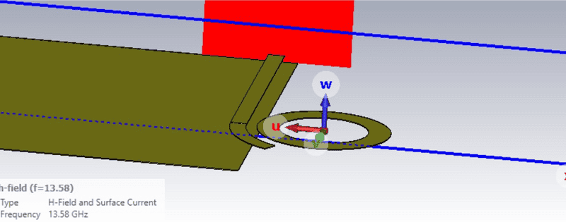

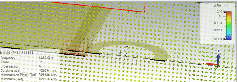

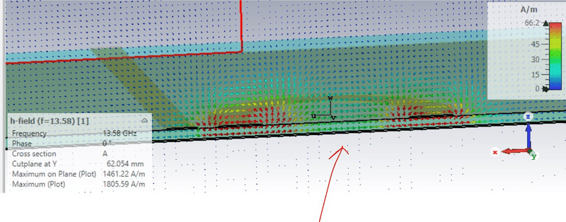

Hello,I remove the ground plane under the ring .
I made the substrate invisible so you could see the remaining ground and the excitation with the ring.
I got a very bad magnetic field .
Its not in the W direction ,its not even closely homogeneous.
Is there something that I did wrong?
Thanks.
It looks to me like you are exciting the ring as two semicircular dipoles, touching at the ends. Maybe the geometry of your coupling is defining that mode. It may require two points of coupling in quadrature, to define the direction of the circular current in the ring.
The ring circumference may have to be much smaller than a wavelength, for a circular current to form in the ring. With a ring circumference equal to one wavelength, the centre will be surrounded by one full cycle of the wave current, so at the centre of the ring, the magnetic field generated the current in the ring, will cancel to zero.
I agree with #4. Maybe make the circumference small compared with the wavelength and obtain resonance by cutting the ring and inserting a capacitor.

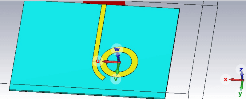

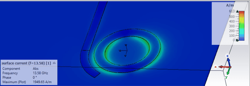

Hello Balunecore,I succseeded to implement your advices and made a breakthrew .
As you can see I removed the ground plane bellow the ring and I got the H-field prepandicular to the plane.
How do you recommend to increase the coupling to this mode?
Is there some intuitions I could use?
Thanks.

Well done.
With the ring free of the ground plane, and the capacitor suggested by @tech99 you have made an LC resonant tank circuit. You could couple to it capacitively at two points, or with a nearby inductive coupler like the j shaped track. You might think of the LC tank as the secondary of a transformer, or couple to it with a dipole antenna matching network.
That j shaped track was being reflected in the ground plane, then coupling into the ring. Without the ground plane, you must directly couple between the j track and ring, or place a short ground plane track to do the coupling.
Maybe it is time to study directional couplers, and the difference between odd and even modes of coupling.

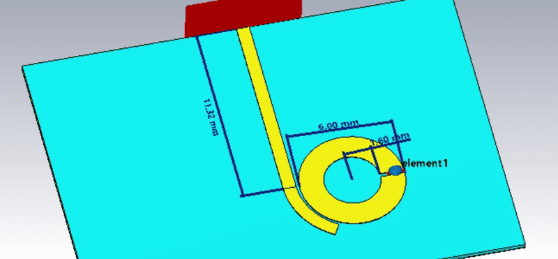

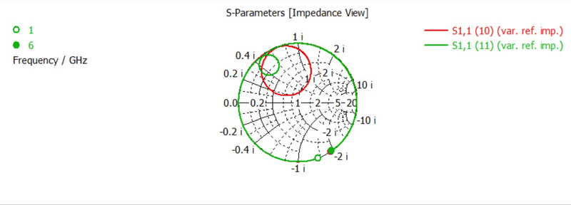

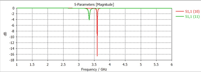

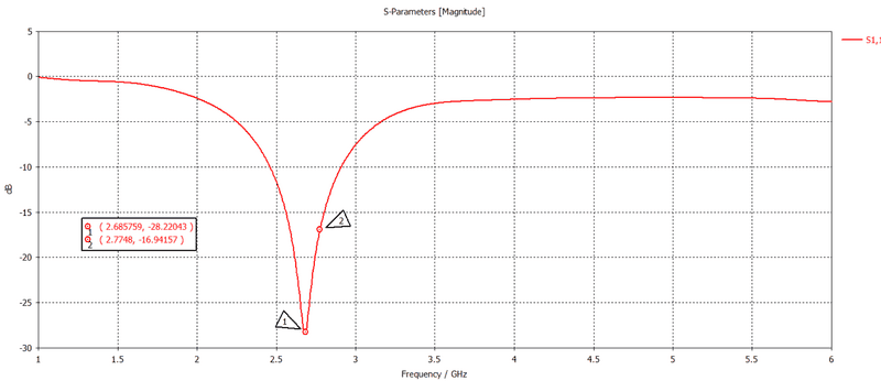

Hello,The best method I got to increase the coupling is by moving the ring to a place closer to the excitaion source as shown below.My capacitor at the best coupling phase was 0.5pF and 0.1OHM series resistor.
red plot is 1Ohm series resistor of the capacitor.
green plot is 0.1Ohm series resistor of the capacitor.
All the 0.5pF capacitors I saw are with 1Ohm series resistance.
When I changed the series resistance to 1Ohn I got the coupling dropped drastickly.
So this coupling mething is not working so much.
I know the design of a directionial coupler and the even mode analysis.
How can I implement it here to get a good coupling?

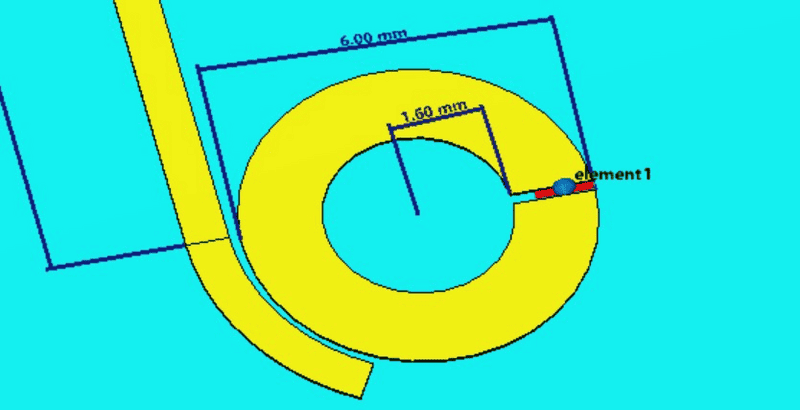

Hello Baluncore,I started something which is almost works good :-)
It would be great if I could further improve the coupling to the mode made by this ring.
in the last post I showed results ,Can you recommend a way to improve coupling ?
Thanks.
To improve coupling, something will need to change.
Please answer my questions in post #12, so I can work out what to change.

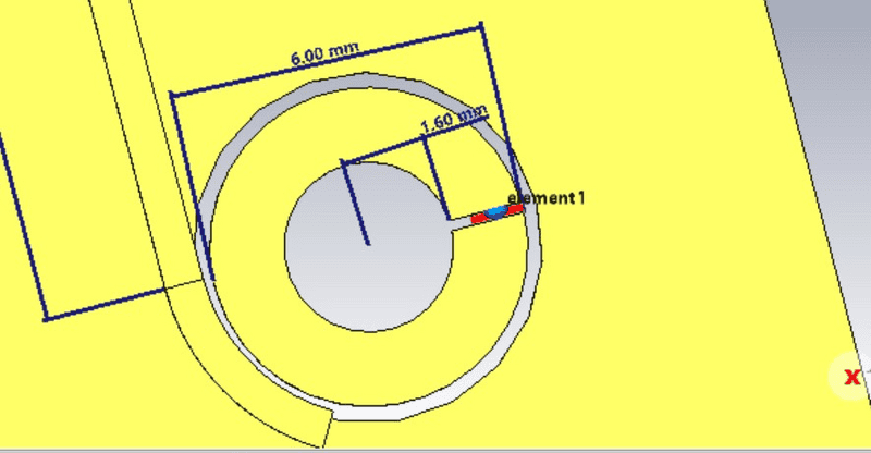

I have built the following resonator.
It has magnetic field normal to the substrate plane.
Is there some matching intuition I could use of the ring to the excitation.

You are asking a question with impossible constraints.
Any closed ring, with a circumference that is small in wavelengths, will not be resonant.
A transmission line on a PCB will not work. Any ground plane, or track below a ring, will induce an equal and opposite current, that will cancel the axial B field.
You need an inductor that is resonant with a capacitor. The volume inside the inductor will have a high axial B field. The inductor will need to be wound with a short wire, so will have only a few turns. The current within the inductor should not vary significantly along its length, or it will become a transmission line that cancels its axial field.
The resonant circuit will need to be enclosed by a larger rigid conductive screen, or box, to keep interference out, while keeping the resonant signal in. The screen must provide isolation, so the internal EM environment will not be influenced by the external movement of the operator. The resonant circuit will see itself, like an antenna, reflected from all the internal surfaces of the screen. The cavity inside the screen must be dimensioned to support the resonance.
The sample for analysis will need to be placed in the end of an insulated rod, then introduced into the somehow resonant chamber, by pushing it in along a guide tube.
That system is very different to your imagined resonant ring, etched on a PCB. The scenarios are so different that there can be no transition between them. Your resonant ring cannot be made to work.
purely on RF point of view there are capacitors inductors the ring and the excitation trace.
Is there some intuitions that will do a good coupling for the mode?
Thanks.
You need to build a resonant loop antenna, that has a high circulating current. It will be a small inductive loop, with a physically small, yet high capacitance in series.
You need a high impedance coupling network to the low impedance antenna loop. That impedance ratio should be close to the Q of the loop antenna.
You need to avoid building antennas, couplers, and transmission lines, on double-sided PCB material.
