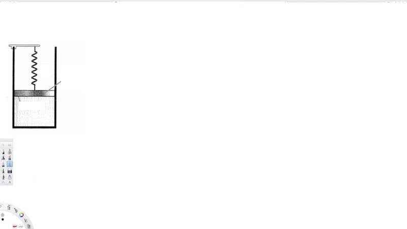

A non-conducting piston of mass m and area of cross section A is placed on a non-conducting cylinder.
Intial height of piston is h and spring is relaxed with a spring constant k.Then,work done in displacing pistin by heating gas is (x is the displacement of the pistion)
The diagram is of a cylindrical cylinder with a piston and a spring attached to the pistin in the middle .The spring can be compressed without any restrictions
I thought of applying the work energy for this system but due to heat as well as change in internal energy,I think it won't work

First of all you need to tell us what the question is. Second, you need to explain the set up better or provide a drawing. Finally, you need to show in a bit more detail what you have done to solve the problem and explain why you think your approach does not work.

The only thing I had thought for this was to use work energy theorem because no other informations were provided
I thought of using- W gas+W atm+W spring+W gravity=KE(final)-K.E (Initial)
However since the gas is heated there because of heat therefore I don't think this will apply

Are you taking a formal course in Thermodynamics currently?
Since you would seem to like to apply concepts from freshman physics to this problem, using a free body diagram, what is the algebraic force balance equation on the piston?
Also, as Andrew Mason has requested, please provide an exact statement of this problem. If your next response does not include that exact wording, this thread will be deleted.
