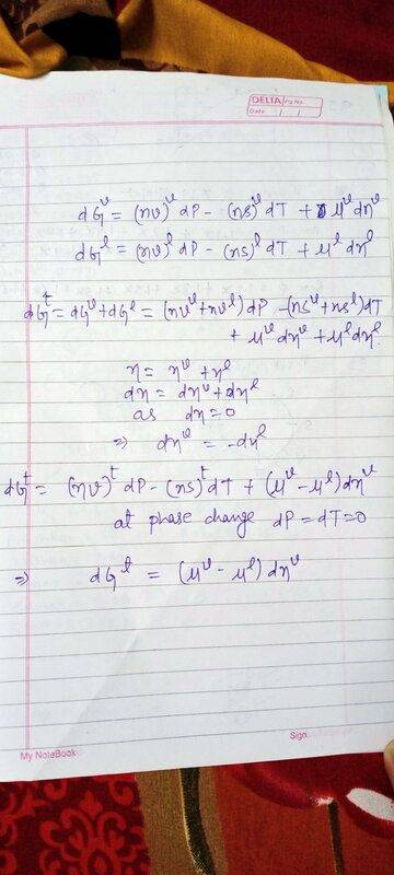

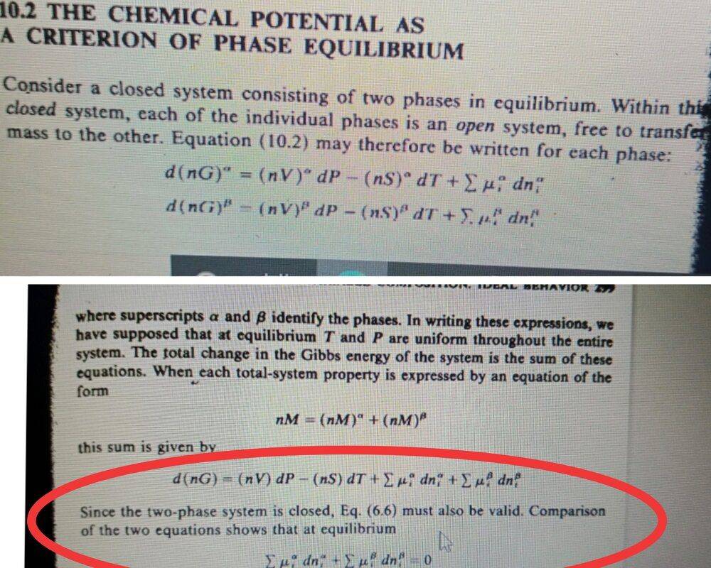

I have two doubts here on:
1)
In the first line of picture I uploaded it says consider a closed system consisting of two phase in equilibrium . That means we talking about two different phases where our species is being transferred from one to another, that is it isn't a system of homogeneous phase also we will not have a constant composition as at equilibrium composition might be different in the two phases . In the red curve I marked, it says cause its a closed system so we can use eq 6.6( the equation we talking about dg=vdp - sdT). But isn't this equation applicable only where there is homogeneous phase and constant composition ?
2) Let's say we have a closed system where water is boiling , I want to ask , the moment when the quality of steam has reached 0.5 , can we write dg(liq)=v(liq)dp- s(liq)dT+ μ(liq)dn(liq) , as of course during the process when the quality of steam reached from 0.1 to 0.5 , mass transfer has taken place, and the moles of liq water has reduced . But looking from other perspective this only liquid part in this system is homogeneous as well as constant composition as it is pure that is , this is applicable dg=vdp - sdT . I'm confused here , can't draw any further understanding out of it.
1)View attachment 267519
Apparently, it also applies to any closed system (dn=0 for all species contained within the closed system).
In your first equation, is g the free energy per mole or the total free energy of n moles?
Lets consider it total free energy of n moles
OK. Then write a similar equation for the vapor phase and add the two equations together. What do you get?
Further in post#7 you proved that total gibbs free energy change is 0 during phase change , so further solving it will end up with μ(liq)=μ(vap).
Correct. And this equation also shows it because dnv is arbitrary.
So can we conclude that the only requirement to use this equation of Total Gibbs free energy change
d(ng)=(nv)dp - (ns)dT.
is that the system must be closed or if its open system then the Molar Gibbs free energy will remain constant provided the composition is constant .
If I understand you correctly, yes, in an open system, the molar Gibbs free energy will remain constant provided the composition is constant (at constant temperature and pressure). See the derivation of Eqns. 11.4 - 11.6 in your book.

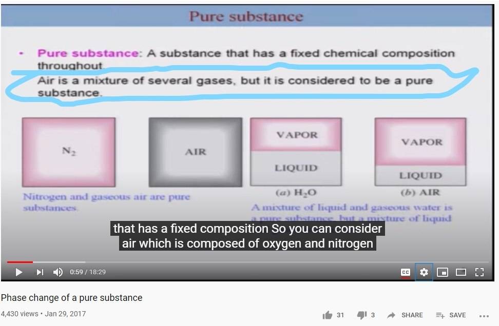

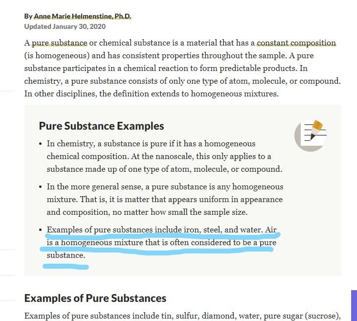

I was actually super confused because of this above thing that I attached .
Can we conclude that
1)Air is a homogeneous phase with constant composition , liquid water or liq vapor separately taken are pure substances also separately they are homogeneous phase with constant composition while there liq water + water vap mixture is heterogeneous phase with constant composition ?
2) Pure substances are single component(either element or compound) in a homogeneous phase with constant composition .
3) Can I say a mixture of water and lemon juice( considering lemon juice as one component here for a while) mixed perfectly is an example of homogeneous phase with constant composition , while they both separately are pure substances ?

These definitions don't conform to any thermodynamics book I've ever seen, and certainly not to Smith and van Ness, the textbook you were discussing earlier. So I leave it up to you to adopt whatever analysis and definitions please you.
1)Air is a homogeneous phase with constant composition, liquid water or liq vapor separately taken are pure substances also separately they are homogeneous
phases
while liq water + water vap
is a heterogeneous mixture of pure phases.
If they are pure, by definition they are of constant composition.
yes, if you consider lemon juice as a single component. It is really as solution (mixture) of several pure organic substances (e.g., acetic acid)

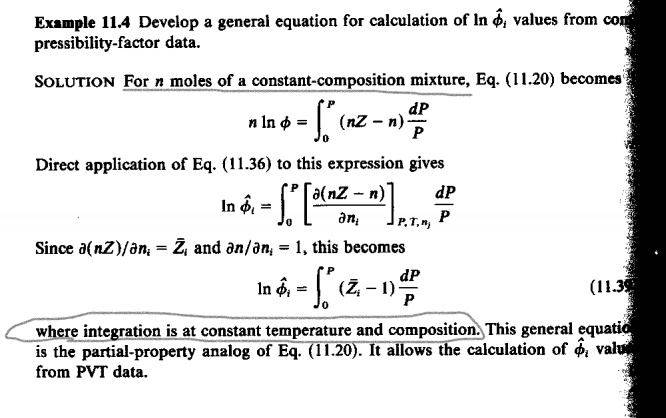

Sir Chet here in this example it says ,For n moles of a constant composition mixture and integration is at constant composition. Does that mean we can't use this equation of fugacity coefficient for a system where there is change in composition occurring ?
Also, We know that Partial molar Gibbs energy for species i in solution is equal to RT times the
##ln\hat {\mathbf \phi_i } ## , and according to equation of partial molar property , partial molar property of a species i varies with the changes in composition of species i , hence ##ln\hat {\mathbf \phi_i } ## should also change with change in composition, But then this attached example talks about constant composition . I know I am missing something here, would you please help me out with this?
No. It means that this equation applies at any specified composition.
As I said, this equation applies at any specific composition of the gas mixture. But, of course, it would give different values of the fugacity coefficient of a species for different mixture concentrations, temperatures, and pressures. Do you understand how it would be used in practice?
