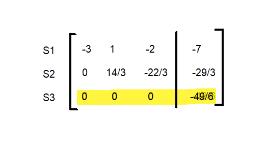

I get it but I had wondered this case which I add below. Isn't it time wasting making an effort to solve whole question again
Augmented matrix in row echelon form with rows labelled S1, S2, S3: S1 is -3, 1, -2 | -7; S2 is 0, 14/3, -22/3 | -29/3; S3 is 0, 0, 0 | -49/6, with the S3 row highlighted in yellow.

Calculate the determinant (I get 0). There is no solution! That's the problem!

Why don't you compute the determinant of the original matrix to see if it is 0 too? Not a guarantee if it is, but shows a problem if it is not.

The determinant of the original matrix is 0. I don't know what happens if a determinant of a matrix is 0.

One of the consequences is that there is a vector b for which Ax=b has no solution. And the matrix is not invertible.
The determinant is 0 means that the equations are not linearly independent, so you can't get a solution. Getting (0,0,0) for the left side after Gauss elimination is equivalent to a 0 determinant.
A zero determinant means that there is no unique solution. There could be many solutions or there may be none.
In this case, there is no solution. Your calculation leading to an obvious false equation is proof of that (although I haven't checked your work). An easier calculation process would be to add 3*row3 to row1 and subtract 5*row3 from row2. That will give you new row1 and row2 which are clearly contradictory: ##7x_2-11x_3=-10## and ##-7x_2+11x_3=7##.
