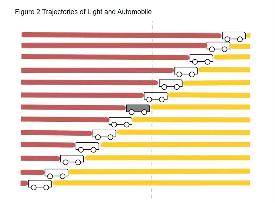

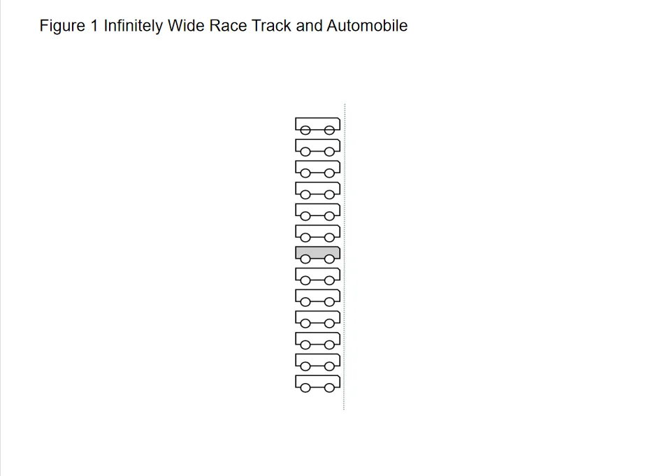

This paper constructs a thought experiment model based on reference frames: an infinitely wide straight track is assumed, with an infinite number of motor vehicles arranged at the starting line. One vehicle is selected as the reference observation carrier and kept stationary relative to the track. Vehicles on both sides of this stationary reference vehicle move at constant speeds in opposite directions, one moving forward and the other backward, and the speed difference between any two adjacent vehicles is infinitesimal. All vehicles turn on their on-board light sources simultaneously. Observation directly above the track reveals that there exists a vehicle with identical optical path lengths for its red light and yellow light. Repeating this experiment on three mutually orthogonal planes enables the establishment of a fundamental reference coordinate system.
1 Is the speed of light determined by intrinsic physical properties? Is the speed of light affected by observers? For two mutually opposite velocities free from external interference, does there exist an external-perturbation-independent zero velocity?
2 In Figure 2, high-speed moving objects exhibit directional dependence relative to the speed of light in vacuum; no shift of interference fringes is detected in experiments. Is there a theoretical contradiction between the two phenomena?
“Simultaneous” according to whose reckoning?
Is it also infinitely long?

In Figure 2,
Figure 2 is wrong. You cannot conclude anything about physics from a figure that doesn’t correctly represent physics.
...but which vehicle will depend on the state of motion of the sensors doing the observation. Or whatever's absorbing the lights. Or something of that nature. It's hard to tell exactly what because the experimental description misses out too much.
If the line of cars is infinite, an external observer cannot be equidistant from all of them. The observer will therefore receive the light signals at different times and will not literally see all the cars start simultaneously.

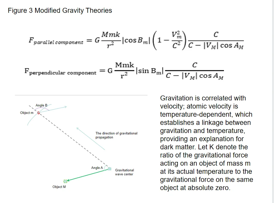

I am also confused by the gravity part. If the cars are not in inertial frames, then the propagation of light itself may be affected, so it is not obvious what comparison is being made.
