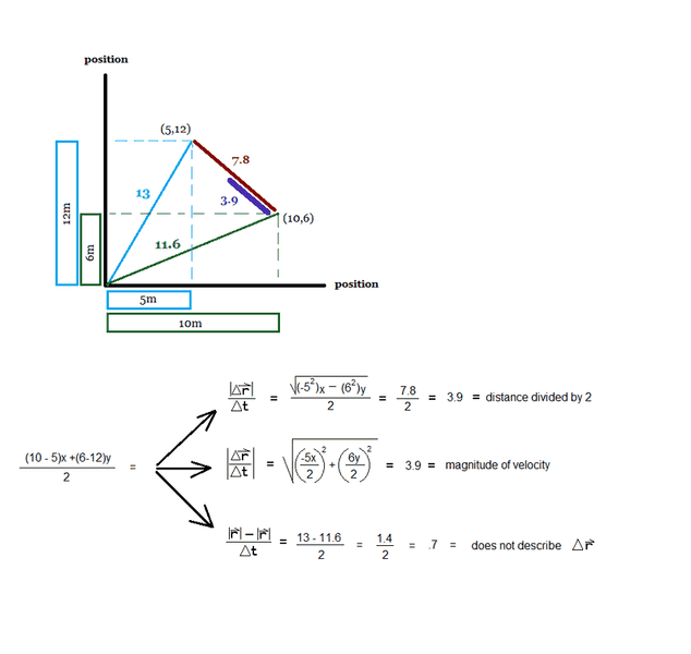

Here's an illustration of what I'm trying to understand more clearly.
What is incorrect here, if anything?
I don't understand where your getting the last line from??
The top two lines of working are correct (besides the -5, it should be +5. but since your squaring does not matter.) and are the same thing and describes the resultant vector.
If you want to find half the resultant vector then just divide by two. I don't understand where the last line of working out came from and its use??

and yea, -5 and 5 and -6 and 6 are switched because I wrote it in the first equation one way, but subtracted components the other way while I was typing it into microsoft paint...and ur right, same thing since I'm squaring.
And regarding the last equation, lrl - lrl is from √(5^2 + 12^2) - √(10^2 + 6^2) difference in the magnitude of each vector... which I would suppose would not be applicable to finding average velocity.
No because its not the distance formula. to make this work you would have √ ((10)^2 + (12)^2) - √ ((6)^2 + (5)^2) & then dividing by two.
Just the same as using the distance formula, it is always the bigger x value - the samller x value, and same goes for y values.
So you'd confirm that everything in that illustration (besides the negative signs within the distance formula) is accurate?
