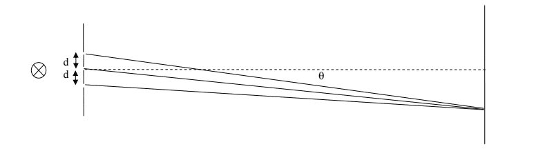

Find at which angles θ the interference picture that appears on a distant screen
made by three thin slits separated by distance d and enlightened by a source of wavelength λ (see figure)
a) Shows its maxima.
b) Shows its minima.
multiple slit diffraction, d, ##\lambda##, ##\theta##
$$dsin\theta=m\lambda$$
$$dsin\theta=(m\lambda)/3$$
$$E(t)=E_0cos(k(r_2-r_1)-\omega(t))$$
$$t=top,m=middle,b=bottom$$
$$E_t=E_0cos(k(r_t-r_b)-\omega(t))$$
$$E_m=E_0cos(k(r_t-r_m)-\omega(t))$$
$$E_b=E_0cos(-\omega(t))$$

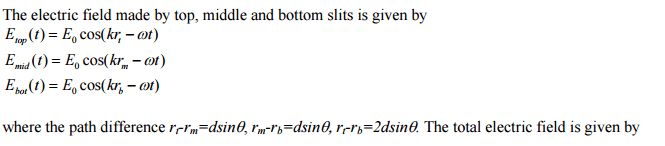

However, the solutions gives me something like this.
My thought process was that the top ray travels the most or has the biggest path difference. I don't get why the solutions give me these equations. Or am I getting my path differences mixed up? Thanks for the help.

I don't know how advanced your textbook is, but if you have the formula for the interference pattern for ## N ## slits (It works for any integer N that is 2 or greater): ## I(\theta)=I_o \frac{\sin^2(N \phi/2)}{\sin^2(\phi/2)} ## where ## \phi= (\frac{2 \pi}{\lambda}) d \sin{\theta} ##, you can use it to solve for ## I(\theta) ## for the case where ## N=3 ##. ## \\ ## The zero's of the function ## I(\theta) ## occur when the numerator is equal to zero, except when the denominator is also zero. When the denominator is also zero, along with the numerator, you get a maximum and ## I(\theta_{max})=I_o N^2 ##.(You can take the limit where ## \theta ## approaches that angle. At that precise angle, the expression is undefined, but assumed to be the same value as the limit.) ## \\ ## I will let you try to work out this result assuming you are allowed to use this formula. It's a simple matter to determine the angles ## \theta ## for which the numerator and/or the denominator is equal to zero. ## \\ ## Note: If you wanted to work with sinusoidal ## E ## fields, instead of simply using the formula for ## I(\theta) ##, ## \phi ## would be the phase of the middle slit, with the top slit at zero (relative phase), and the bottom slit at ## 2 \phi ##. The algebra for the case of just 3 sources isn't terribly complex (using trigonometric identities to compute the sums, etc.), but it is really easier to just use the general formula given above.
One additional comment is the formula for the intensity for N slits is derived by first summing sinusoidal E fields using complex variables (## exp(i \omega t) ## etc.,) and summing the geometric series. For N=2 and maybe for N=3, it is possible to do this calculation using ## cos( \omega t) ##, but for anything larger, it is much easier to do this calculation with complex variables.
