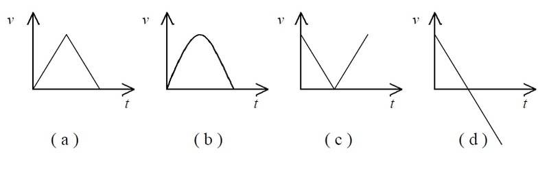

A ball is thrown straight up and it falls back to the ground.
Which one of the
following graphical representations describes the velocity of the ball as a
function of time.
I think the right answer is D, However i think it can also be C.
Tell me what you think!

Well, D because when we throw the ball, it will reach a time when the velocity will come to zero, and then it will fall, so basically there are two steps..
Step1: a1 < 0 and v1 > 0, a1*v1 < 0, so there is decceleration.
Step2: a2 < 0 and v2 < 0, a2*v2 > 0, so there is acceleration.
same thing for graph C

These diagrams show velocity as a function of time. Using them, how would you find the acceleration? Which diagram matches what you (should) know about the acceleration of an object in free fall?
The acceleration is simply a1= difference of velocity during that step/difference of time during that step

hmm … i find that rather confusing …
by "acceleration" we usually mean acceleration in a particular direction (eg up), so that the acceleration of a projectile is always negative
so the test is:
a < 0 means there is negative acceleration
a > 0 means there is positive acceleration​
your method seems to be defining "acceleration" as meaning that the magnitude of the velocity increases (so a projectile always decelerates on the way up and always accelerates on the way down)
i don't like your method at all, it's so complicated
surely a < 0 is an easier test than a*v < 0 ? :smile:
oh, and i still don't understand why, even on your test, you think C might be right :confused:
Yes C might be right too because when we apply that method which you don't like :D we find same thing as D

Exactly right. So how do the accelerations exhibited by diagrams C and D differ? Hint: Pay attention to signs.
if we take the method of looking only to the acceleration, i think the answer would be C only.

What property of a velocity versus time graph tells you the acceleration?
Realize that acceleration is a vector and thus has direction (and thus sign).

now I've slept on it :zzz:, i can see why your method is giving you C as an alternative answer
when the projectile comes down, it is accelerating (ie the magnitude of the velocity is increasing), so your method requires a*v to be positive
in the graph C, a and v are both positive, so from that point of view C is consistent with that
(and so is D, the correct answer, with both a and v negative)
unfortunately, C corresponds to half a parabola on the way up, then the other half of the parabola upside down, with the projectile accelerating off into outer space :rolleyes: (so that the whole thing looks a bit like a y = x3 graph)
(can you se that now?)
i hope you now see that this acceleration/deceleration method, using the sign of both a and v, is potentially misleading, and it's best just to talk about positive and negative acceleration, and use only the sign of a :smile:
Ok Tiny-tim,
it's a good point to clear up this confusing matter, i will use only 'a' to see if there is acceleration or deceleration, with a = difference in velocity/ difference in time.
and then the answer would be only C.

why C ? :confused:
in which direction are you measuring v and a ?
because
in step 1
a1= (0-v)/(t1-t0) and we get a negative value.
in step2
a2= (v-0)/(t2-t1) = positive value.
so it makes sense.

What's step 1 and step 2? Are you still looking at diagram C?
Is the acceleration of a falling body sometimes positive and sometimes negative? (Which way does gravity act?)

chawki, what you are saying (correctly) is that in step 1 of graph C, the acceleration upward is negative, and in step 2 of graph C, the acceleration upward is positive …
as Doc Al :smile: is hinting, do you really think that is correct for a projectile under gravity? :redface:

In step2 the acceleration is DOWNWARD and it's positive.
it makes sense because when we throw upward , a is Negative, and then the ball reach a pooint where its velocity comes to zero...before falling free and then the acceleration is Positive...and all this matches C...still convinced :shy:

What sign are you using to represent downward? Those diagrams assume that up is positive and down is negative.
Don't just think in terms of the magnitude of velocity, direction counts.
Answer this: What does a positive (> 0) value for v mean in those diagrams?

I'm using downward as (+) upward as (-)
no matter what the methods are..we should compare results to logic.
both C and D are correct.
Chawki I think you are confusing yourself with acceleration - ignore it for a moment and think only as velocity...
The speed of the ball (not velocity) starts off greatest just after the throw, reaches the apex where speed is zero, and drops back under gravity. So, sped (again not velocity) would show C.
Now velocity is not scalar, it has a direction component. As the ball is launched, gravity is slowing it, so it drops in a consistent manor (in a perfect example) over time until it meaches zero. Step 1 (?). Then it falls, but now the direction is reversed, so as the magnitude rises again (its speed increases), it gets more negative - thus D is the answer.
