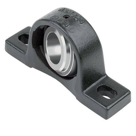

Ok, so this is an undergraduate level question probably but consider this
R. C. Hibbeler's Textbook on Mechanics of Materials says this about thrust bearings and smooth journal Bearings :
In other words, it says nothing about reaction moments. Now this chart has other 2D connection types that include a counter or reaction moment such as a fixed support that has 3 unknowns in 2D (M, Fx, Fy) or 3 reaction forces. So it's safe to say already that Hibbeler does not consider journal and thrust bearings to have reaction moments.
But to double check that he's saying this I looked at the first problem set
Now you are probably wondering how to solve this while consider the reaction moments at A and B, but before you strain yourself on that idea just take a look at a solution manual and you'll see it doesn't consider them at all. It leads to answers of 233 N for the resultant internal loading at point C and 433 N*m for the bending moment.
A quick search and general intuition would tell you there are probably reaction moments at both A and B or on both thrust bearings and smooth journal bearings.
The rod a is long cylinder in-closed by a 'bracket' with a cylindrical hole in it. If you slide a cylinder in a cylindrical hole it's only going to turn about its axis. Turning perpendicular isn't going to work thus a counter moment. As shown below (results for searching thrust bearing reaction forces)
And again
In most results you see a reaction moment in the X and Z axis, yet this is and my own intuition is inconsistent with Hibbeler's textbook.
Are there different types of bearings that do or don't have reaction moments in the X and Z axes? Is Hibbeler wrong, is my intuition and these searches wrong? Is everyone wrong? Are they both right? Is this simple a common different 'flavor' of material?
What am I missing here? This shouldn't be so difficult, at least not unless I'm missing something major.
I think the bearings you mention (journal and thrust) aren't normally designed to tolerate significant moments. Moments would tend to twist the bearing out of it's housing. They should be eliminated by having multiple bearings along the shaft and reducing pulley overhangs etc. I'm speculating that might be why they weren't considered by Hibbeler?

Some of these bearings and bearing mountings are self aligning and would provide no resistance to a moment...
On first thought, this would only be true if it were the only bearing on the rod. If you put two bearing mountings that are self aligning on the same rod (such as on the example problem) then self aligning wouldn't be able to happen since the two mountings are fixed and pointing at each other by the rigid rod connecting them.
But then on second thought I suppose it wouldn't be providing resistance to the moment itself, rather channeling it from the other bearings in the series reaction force (in x or y) ...much like a fulcrum.. so no need for the reaction moment.
Correct me if wrong
Not sure I follow your first paragraph but the second seems correct.

But then on second thought I suppose it wouldn't be providing resistance to the moment itself, rather channeling it from the other bearings in the series reaction force (in x or y) ...much like a fulcrum.. so no need for the reaction moment...
A shaft running at moderate speed and in a stable condition can usually be treated like a simple beam and load distribution , shear force , bending moment and deflection can all be worked out using standard analysis methods .
The bearings provide points of fixation . The type and degree of fixation depends on the bearing configuration .
Calculations for stress can be a little more difficult . We can discuss that problem later if you wish .
At higher speeds shaft stability becomes a problem and more complicated analysis methods are needed
