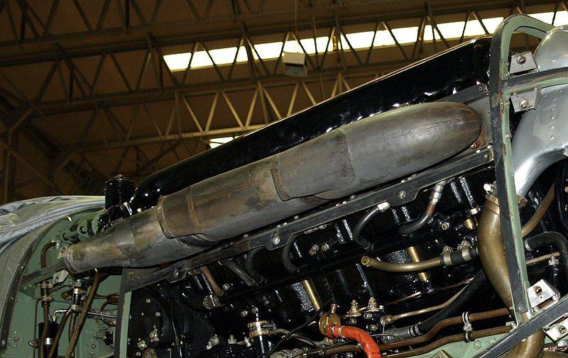

I don't know how this would relate to your model, but with the Merlin engine in WWII somebody realized that the simple modification of directing the exhaust backwards, instead of a "straight" exit sideways relative the the plane, was worth about a 5% increase in engine power, and 10 knots on the top speed of planes like the Spitfire.
Isn't the important quantity the change in momentum, rather than the exhaust velocity?
My guess is that with the induced prop wash flowing past the exhaust, the end result was partial vacuum at the exhaust, creating a scavenging effect. A change in momentum would normally not result in an increase in power, only a reduction in pressure at the exhaust ports of the engine.
