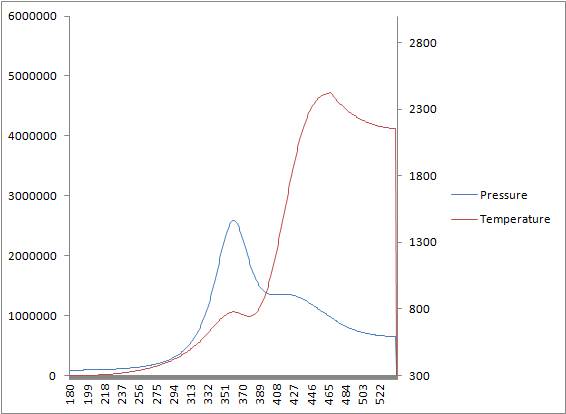

You don't want to ignite the fuel-air mixture before maximum compression is reached, otherwise, the engine is working against itself. Likewise, you don't want the spark to occur after max. compression is reached, because then you lose efficiency because the mixture is not fully compressed when ignited.

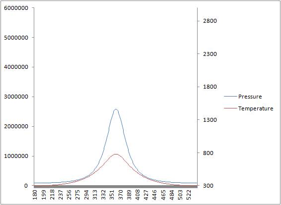

If you forget the charge for a minute, and just consider the piston compressing and decompressing air, then you'll know that as the air is compressed, it's temperature rises.
The temperature and pressure traces would look a bit like this.
Igniting the charge earlier means the mixture is burning as the piston is still rising up the cylinder on the compression stroke. The burning increases the temperature, which increases the pressure, but at the same time the piston is also increasing the pressure which increases the temperature!
Here's how the temp and pressure traces look when the charge is ignited 45° before TDC.
We can see that the two effects combined increase the pressure and temperature dramatically. The fuel is still burning past TDC, so the temperature continues to rise even though the piston is now descending down the piston which expands and cools the gas slightly offsetting the increase in pressure and temperature from the fuel burn.
Now consider what would happen if we ignited at TDC. The piston is now descending down the cylinder, again expanding and cooling the gas. This effect works against the increasing temperature of the fuel burn, meaning although the temperature from the burn is still high (still the same energy going into the same mass of air) the overall pressure is dramatically reduced.
You can see that the pressure and temperature are already dropping before the fuel burn really gets going. Notice also that because it takes longer to get going, there is more residual heat left at the end of the stroke, which increases EGT and also transfers more heat to the head and cylinder walls, which in turn will go into the water jacket.

The impression that I'm getting especially by looking at the graphs Kozy supplied is that the burning mixture can't perform much of any work if the container for it is too large. In the last graph showing late ignition timing it seems like the piston has run away from the flame. I don't know much about their relative speeds but it looks like the temperature gets very high because the fuel is still burning, but little pressure is achieved because the effective chamber has grown so much that for the same volume of gas there is less pressure.
So if we lose some of the pressure we would have gotten on the piston then we lose a portion of the energy contained in the fuel. But it has to go somewhere so it seems the residual heat goes out the exhaust and finishes burning out there. So I would expect more heat transfer to exhaust valves, manifold, guides, and catalyst with late ignition timing as it seems we are effectively burning fuel in the exhaust stream.
As for advanced ignition timing because of the compression effect that works against the expansion of the burning charge we will have more heat energy, and because the burn takes place in a smaller more confined effective area we will get higher pressures and therefore higher temperatures. I would expect more heat rejection to the combustion chamber, valve faces, and cylinder walls with advanced timing.
