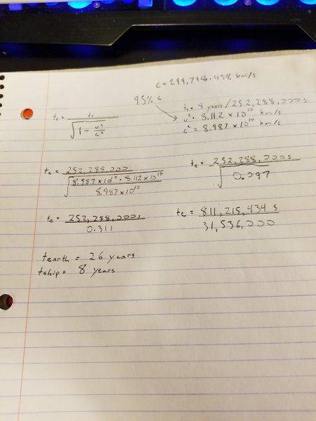

Hi,
We are not learning this in class, but I am giving a presentation on special relativity and as part of my presentation I would like to show that time is not absolute and that if a ship moves away from the Earth for a time t at a speed v then if like 8 years pass on board the ship a greater length of time will pass on Earth due to time slowing down for the people on board the ship.
Here is the work for the calculation. Is it right? I used 8 years ship time for the example (4 years there, 4 years back) and already squared v and c before plugging them in. Any insight is appreciated.
Yes, your calculation is correct. The Earth ages 26 years in the time that the traveler ages 8 years traveling at 0.95 c
The calculation is correct, but it doesn't mean quite what you're thinking it does.
To see the problem, consider that we could just as easily consider the ship to be at rest while the Earth is moving away from it... and then the time dilation formula will calculate that it's on Earth that time is passing more slowly. So we have the apparent contradiction that the ship clock is slower than the Earth clock and also that that the Earth clock is slower than the ship clock.
In fact there is no contradiction. Both statements are correct, and the apparent conflict between them goes away when you allow for the relativity of simultaneity - Google for "Einstein train simultaneity" you'll find much good stuff on Einstein's thought experiment demonstrating that concept.
To see how relativity of simultaneity matters, consider exactly what it means to say that one clock is running slower than another: we're sitting at rest on Earth and we find that clock A on the spaceship reads 12:00 noon at the same time that clock B on Earth and at rest relative to us reads 12:00 noon; a bit later we find that clock A reads 12:30 at the same time that clock B reads 1:00; clearly clock A on the moving spaceship is running slow. That's the time dilation calculation you just did.
But that's the result according to people at rest relative to clock B on earth. Because of relativity of simultaneity, if you're on the moving spaceship you have a different notion of "at the same time". In particular, at the same time that clock A reads 12:30 clock B reads 12:15 and it's clock B that's running slow.
