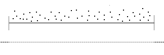

Is it possible to check this assumption experimentally: Travel time of SINGLE photon from the gun outlet to the fringe maxima on screen has to be equal or greater than the longer path divided by speed (c for photon). If the time was shorter, the interference pattern could not occur.
The "travel time" itself is not the critical parameter; it's the uncertainty in the travel time.
Consider: the two different classical "travel times" are ##(a + l_1) / c## and ##(a + l_2) /c##. The difference between them is ##(l_2 - l_1) / c##. So if we measure the times of emission at the source and arrival at the detector, we have two possible cases:
Case 1: The time resolution of our measurements is smaller than ##(l_2 - l_1)/c##. In that case, as @DrChinese has pointed out, measuring the travel time is equivalent to measuring which slit the photon went through, so there is no interference. But you've said you're not interested in this case; you're interested in the case where there is interference.
Case 2: The time resolution of our measurements is larger than ##(l_2 - l_1)/c##. In that case, the time measurements do not distinguish which slit the photon went through, and there is interference. But that has nothing to do with the travel time itself; it's only the large enough uncertainty in the travel time that allows the interference to occur.
Or, to put it in a more provocative way: for interference to occur at the detector, the travel time of the photon must be uncertain enough that it is in a superposition of having gone through both slits; but that in turn means that it is in a superposition of having left the source at two different times, which differ by ##(l_2 - l_1)/c##. The time of leaving the source has to be uncertain to that extent for interference to occur.

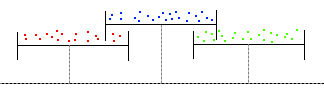

@PeterDonis
Let's assume, that we can get 3 possible, statistical results with ##Δt=(l_2 - l_1)/c##:
##t=(a+l_1)/c±Δt##
##t=(a+(l_1 + l_2)/2)/c±Δt##
##t=(a+l_2)/c±Δt##
Would they be noticeably different? For the sake of argument, let's assume that ##Δt## is slightly greater.

  • #41
@PeterDonis I'm rephrasing it:
Let's assume, that we can get just one the following, statistical results with ##Δt=(l_2 - l_1)/c##:
##t=(a+l_1)/c±Δt##
##t=(a+l_2)/c±Δt##

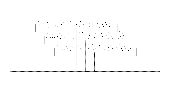

These 3 statistical results are "statistically" distinct. Of course they are overlapping. I want to check which of them is the closest to the experiment. However, if the experiment gives me the wider range, overlapping all of them:
it that case I have no additional information at all. Is this the case?

How about this: the middle of the widest possible range has to be somewhere. I want to check where it is. Why is this also meaningless?

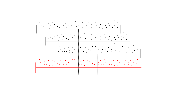

  • #48
@PeterDonis
Would you say, that once again we have even wider range, that overlaps them all?
I could ask this question and update this picture recursively.
  • #49
Yes, you could, which means continuing this discussion is pointless since it could go on forever. You apparently will never be satisfied with any answer we give you. Your question has been answered as well as it can be.
Thread closed.
