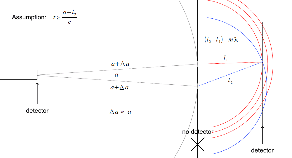

Assumption: Screen detector is much closer to the slits than in "standard experiment" and the small angle approximation can't be used to determine the interference fringe maxima, but the interference pattern still occurs.
Is it possible to measure the time of detection in such setup accurately? If so, how would the time distribution for fringe maxima look like? Could it be calculated from path-integral formulation? Would it correspond to the averaged path length divided by speed? "Time" is the period of time between the emission and the detection.

What's the relevance of the screen being much closer? And, what's the relevance of the time of detection?
You could certainly measure the time that an electron hits the screen, but how do you measure the time it started? Or, the time it passed through the slits?

The point is to make the difference between path lengths (from slits to the same point on screen) relatively greater so they could not be approximated as parallel, to make this difference more significant in comparison to the distance between the slits, so the inequality: slitsDist<<pathLength is no longer true.

As I reckon, any measurement at the slits would destroy the interference pattern, so I want to measure the time of photon leaving the gun, so I need the detector right there.

If we are talking about light (photons) then there is no way to detect a photon that does not effectively destroy it. The exception is where pairs of entangled photons are created and you can measure (gain information about) a photon by detecting its entangled partner.
To be precise the photon is, without doubt, a relativistic particle. And, standard QM is strictly non-relativistic. The description of the double-slit experiment usually skirts round this issue and assumes that certain principles of QM must also hold for photons. Which indeed can be shown experimentally.
To make any genuine comparison (in terms of experimental results matching theory) between light as an EM wave and light in QM, you would need QED or the full-blown QFT.
The double-slit is not the be-all and end-all of QM experiments. One key difference in using QED is not what happens in the double-slit, but what happens when light interacts with matter.

I'd like to know if this is a reasonable assumption: Travel time of SINGLE photon from slits to the fringe maxima on screen has to be equal or greater than the longer path divided by speed (c for photon). If the time was shorter, the interference pattern could not occur.
If you aren't measuring the travel time, you can't assume it has any definite value. To measure the travel time, you would need to measure the time the photon passes the slits, and the time the photon reaches the detector. But, as has been pointed out, the first time measurement would destroy the photon.

I've decided to skip the drawing of the part of the path from the gun to the slits, to make it more clear. Imagine, that the first detector is at the outlet of the gun. I'm also asking is it a reasonable assumption regardless of the measurement.

I'm not trying to detect the photon at the slits. There are just two detectors: the first is at the outlet of the gun, the second is the screen.
Then you can't make any assumptions about the time it takes for the photon to travel from the slits to the detector. Which means you can't make any assumptions about whether or not that time is shorter than the coherence time, which was what you said you were interested in.

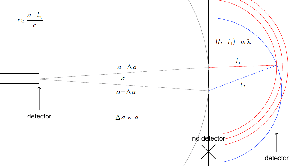

Updated picture:
Updated question:
Is it possible to check this assumption experimentally: Travel time of SINGLE photon from the gun outlet to the fringe maxima on screen has to be equal or greater than the longer path divided by speed (c for photon). If the time was shorter, the interference pattern could not occur.
If such setup would make the time measurement inaccurate due to the uncertainty principle or because of any other reason, I still want to know is it possible to determine the probability of detection in certain point and time by solving the Schrödinger equation or it's modification, or derive it from path-integral formulation. If so, I could know the most probable detection time for certain points on screen, especially fringe maxima, and verify the assumption.

The distance difference (L1-L2) is going to be an integer multiple proportional to the wavelength of the particle. This reference may assist you:
https://arxiv.org/abs/quant-ph/0703126
I think you are asking whether you could measure the time the particle took from when it passed some point at the source until it was detected at the screen. If you resolved that accurately enough, then it would be either L1 or L2. Which it was would then tell you the slit it went through, even though interference had been demonstrated.
Of course, you and I know intuitively already that can't be true. (Precisely because there is interference, the particle could not have traversed a specific slit.) I think your question then is actually: why not? I don't know all the issues that explain that, but here are a few:
1. You would need to know the time of emission of the particle quite accurately. (PS That is no piece of cake. With a laser source, how would you even know how many photons were emitted?)
2. You would need to know the time the particle hit the detector screen quite accurately.
3. You would need to exclude all detections where the travel time was somewhere between L1 and L2; since the result would not indicate unambiguously which slit was traversed.
I am not sure myself of what physical limits exist for the first two. To put this in perspective:
A common 405 nm laser has a frequency of 740228291 MHz, and that requires very high timing resolution. If I did my arithmetic correctly, such a photon travels one wavelength in on the order of 1.3 * 10^-15 seconds (1.3 femtoseconds). Not sure what's out there that could provide such resolution in this particular type of experiment, perhaps others can weigh in.
