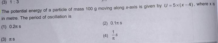

U = 5x2 - 20x
F = -dU/dx
F = -10x + 20
The expression for force doesn't look like motion is SHM .
How should I deal with this ?

Jahnavi said:
U = 5x2 - 20x
F = -dU/dx
F = -10x + 20
What should be the force if a particle performs SHM?
F = -kx
x is the displacement from the mean position .k is constant .
What happens if the mean position is not at x = 0?
OK . So the origin is not at the mean position .If it were then F=-kx .
But here mean position is at x= 2 .
Right ?
Right. I am sure you can now answer the original question.
Yes :smile:
Thanks !
