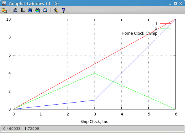

I would appreciate it if some senior member would give me feedback about this result that I have been using in my raytracing simulations of relativistic flight, https://www.youtube.com/playlist?list=PLvGnzGhIWTGR8QYYvMCweXPHtZPnsjrw8.
For simplicity I am assuming that the primed and unprimed coordinate origins concide, and that ##c = 1##.
Starting from the general Lorentz transform in 2+1 spacetime for an observer in the primed frame moving along the ##x## axis at velocity ##v## through a "scene" at rest in the unprimed frame:

Not even wrong, huh?
OK I've spotted my mistake, which is to apply the light cone calculations to events. I am currently testing the real answer (which is much simpler) and will correct this post when I am happy with it.
Apologies fot the intial post, for the record this is how I am doing it now, and it seems to be correct, ie. it gives the right answers for the twin paradox.
"Home" is the stationary frame, "ship" is moving frame. Home clock is at ##(X, Y, Z)##. For each moving object, log all events ##(t, x, y, z)## against the corresponding proper time, ##\tau##.
Define:
##R = \sqrt((x - X)^2 + (y - Y)^2 + (z - Z)^2)##
##T_1 = t + R = ## Home time when ##\tau## is seen on the ship's clock.
##T_2 = t - R = ## Home time seen on ship's clock at ##\tau##
Log ##T_1, T_2## against the corresponding ##\tau## and event.
Plot ##T_2## aginst ##\tau##.
Plot ##\tau## aginst ##T_1##
Done! Plots attached for twin paradox @ ##v = 0.8c##, separation = 4 units, total time in rest frame = 10 units.

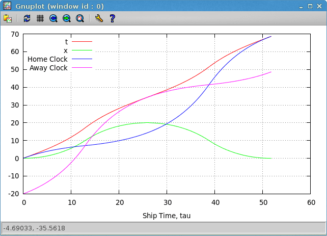

OK, just to wrap this up, here are some real clock times for a twin "paradox" run over 20 light years at an acceleration of (+-)0.103 (representing 0.1g).
And here is the video
Just for the hell of it I have added a clock at the "far/away" end for the Ship time graph.
