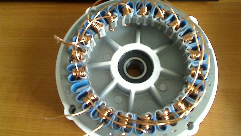

Hi, I am trying to rewind an existing Chinese alternator, it comprises of rotor with 12 magnets and 18 poles (stator), the original design produced virtually no power , aluminium windings have been removed and I have replaced with copper 20 gauge wire, 7 turns per pole, I spin it and nothing, why ? can anyone help me, should I just chuck it in the bin or what
I should add, that I am not bothered about voltage, more important the some power is produced at whatever voltage

We need a diagram of the wiring, and a picture of your stator terminations.
Is it a two-phase, or three-phase stator?
Does it have a rectifier?
Maybe your meter does not work.
Maybe the magnets are not real.
You may have not connected the new stator windings correctly.
We need more information in order to help you.
Maybe it has bad rectifiers.
Maybe you are trying to measure an AC voltage with the meter set on DC.
Maybe you made a bad connection.
Maybe you shorted a winding to the stator.
Maybe you did not spin it fast enough.
And more.....
A photo or two would also help.

diagram, I have simply wired these in 3 sets of 6 coils and star connected them, so three phase at present, can be disconnected and wired in which way way is suggested
no rectifier
meter works fine, any way, two meters
the magnets appear quite powerful for size, supposed to be rare earth magnets
the windings can be connected any way that you suggest, happy to cut and join
JRMitchler, no probs there, ac measurment
no shorts on windings
spin created by electric drill, at least 600 RPM
it says file image invalid, whatever that means ? will try later

The alternator had poor output before the rewind, and now it has poor output. Such a weird thread must involve an oversight or false assumption.
What is the meter's make and model number ?
Is the meter set to measure a low AC voltage ?
I also have an Oscilloscope, I think that I will go and try again, although it's raining hard here, so may have to leave till tomorrow, but thanks for the prompt reply, regards

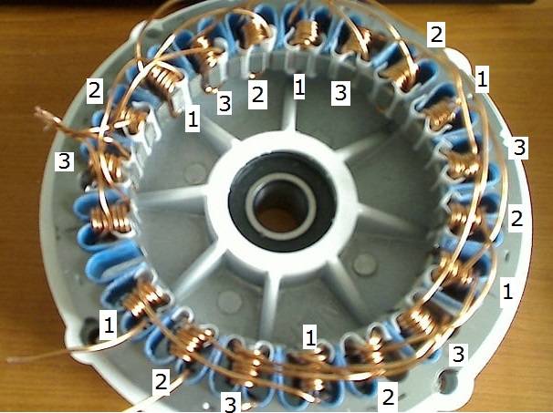

The poles should all be wound with the same sense. The centre of the star appears to have one winding with the opposite winding direction. The phasor diagram will not be symmetrical.
The 12 magnets on the rotor make 6 pole pairs, for three-phase that requires 18 poles to be wound on the stator.
18 is divisible exactly by 6, but it looks like you have one unused pole on the stator, why?

I tried to number the stator phases. There is a problem somewhere.

well spotted, I will change that, the original number of wired poles was 39, but because I wanted to use heavy duty winding, this was not possible to repeat, I didn't think that leaving out every other one would be a problem, bearing in mind that this was my first attempt at playing with windings in this way, note also that I have two sets of 6 and one set of 7, maybe I should remove the seventh coil ?
The pitch of the magnets on the rotor must be the same as the cycle of windings on the stator. More windings on more poles will produce a greater voltage. You may be getting total cancellation by winding every second stator pole. Use thinner wire during testing the phase position of the stator windings.
Identify the orientation of the magnets on the rotor by feeling for the poles with an iron rod, needle or wire. 12 bipolar magnets make either 12 or 24 poles, depending on the orientation of mounting on the rotor.
Draw up a diagram of the rotor magnet poles, showing N & S, against the three repeated stator poles. Make sure the same magnet poles are passing the same phases at the same time. Make sure there is a N&S passing over each set of three windings.

To get three phases to cancel exactly would imply the whole thing is perfectly made but just assembled wrong. What do you get if you disconnect one coil or even two coils. There's no reason why a single coil should have zero volts output even with a magnet waved about near it. So what voltage do you actually get?
There are 39 stator poles shown in the picture.
For 3 phases, there will be 13 possible coils per phase.
That does not synchronously tally with 12 magnets on the rotor.
There must be 13 bipolar N·S magnets on the rotor, making 26 rotor poles.
One magnet, with two magnetic poles, will face each repetition of three phase-coils. Here are the first two full cycles of the 13, in half pole steps.

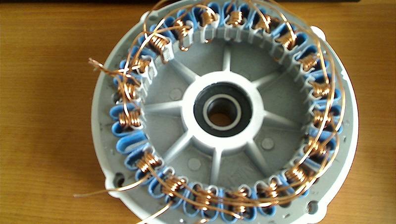

It looks very ... spacious there. How was the original turn count and thickness?
Usually the cross section reserved for the windings is in sync with the sum of all copper possible (for saturation) and such extra space would mean serious 'underwinding'

Exact type of the device, then? Maybe some pictures online somewhere?
On an experimental approach: I would just fill up those winding spaces there, with finer wire ...
