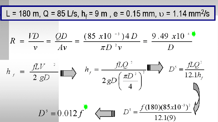

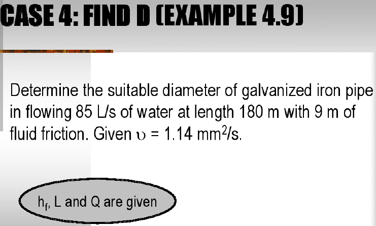

when we find the diameter of a pipe , we have to found the value of D and f by iteration , how to choose the start value of friction factor when we do the iteration ?

Have you looked at the graph of friction factor vs Reynolds number?
you mean moody chart ?
Yes. You can see that on the chart, the friction factor does not very by several orders of magnitude, at least not for turbulent flow. I would start out with the value at a Re of 105.
how to determine the value to start with ? the Re and relative roughness is not given ?
Like I said, start with the friction factor f for Re = 100000. As far as roughness is concerned, you would have to know that for the particular pipe from its specs or just assume a worst-case value.

yes , this is a homework -like problem , the roughness , e is given , but we don't know the D , how to get the relative roughness(e / D) so that we can choose the friction factor ?
Once you know D, you will have e/D for the next iteration. So just assume smooth for the first iteration.

But, we do not know D, how to assume the value of D?
1. Guess value of D
2. Calculate Re
3. Calculated e/D
4. Determine f
5. Determine hf and compare with required value
6. Determine difference
7. Go back to step 1
8. Make a graph of either hf vs D or (hf difference) vs D.

so , we need to assume the value of D first ?
That's what I would do. Choose values for D that give you the exact values of e/D on your Moody chart.
