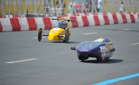

What helps reduce aerodynamic drag better wheels inside or outside in reference to the above designs? please help.
tt101 said:
Two streamlined human-powered recumbent vehicles racing on a road past red and white barriers; a purple car in the foreground and a yellow one behind it, with riders inside enclosed fairings.
What do you think? What research & reading have you done so far? Is this question for schoolwork, or are you designing such a car for yourself?
yes this is for a project I am working on. According to my knowledge tires outside should be better since the frontal area reduces as compared to when the tires are placed inside. As the area increases the opposition also increases. But also the tires being covered reduces drag over the tires. thus the confusion.
