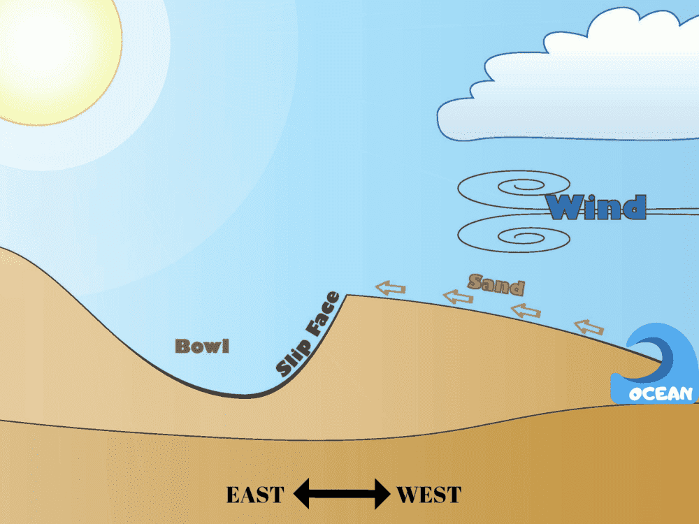

If the sand is at close to it's rest slope, such as in the lee of a dune, it will not be possible to climb the slope.

In the lee, where the slope is so steep that it is at the transition to flowing, you could keep pumping sand with the tyres, from above in front, to behind and below, until you had cut a ramp, with side batter, through the dune wide enough for a vehicle to pass.

Crawling slowly up the flowing lee of a dune at it's angle of repose will be particularly difficult, if not impossible.

https://ohv.parks.ca.gov/pages/1170/images/Sand Dune Vector with direction.png

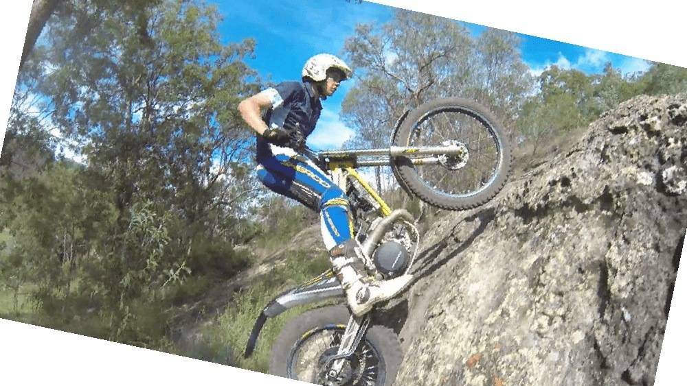

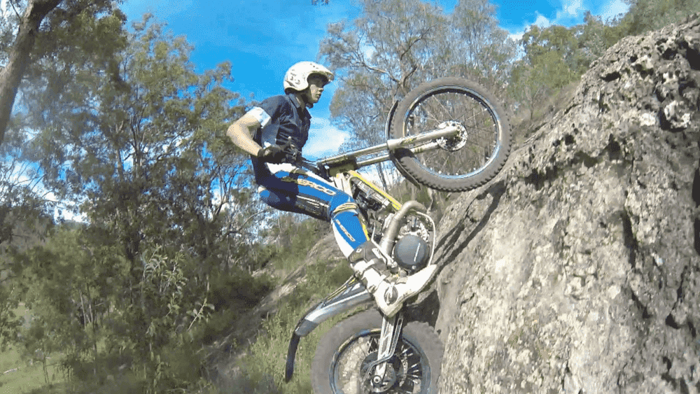

But I'm not sure that the optimum climbing profile for slippery slopes can incorporate no slipping. Trials bikes proceed pretty slowly over obstacles, but over slippery uphills, I'm pretty sure they also use extra wheelspin to give maximum forward thrust...

That picture looks much more realistic when the trees behind the rider are restored towards the vertical.
