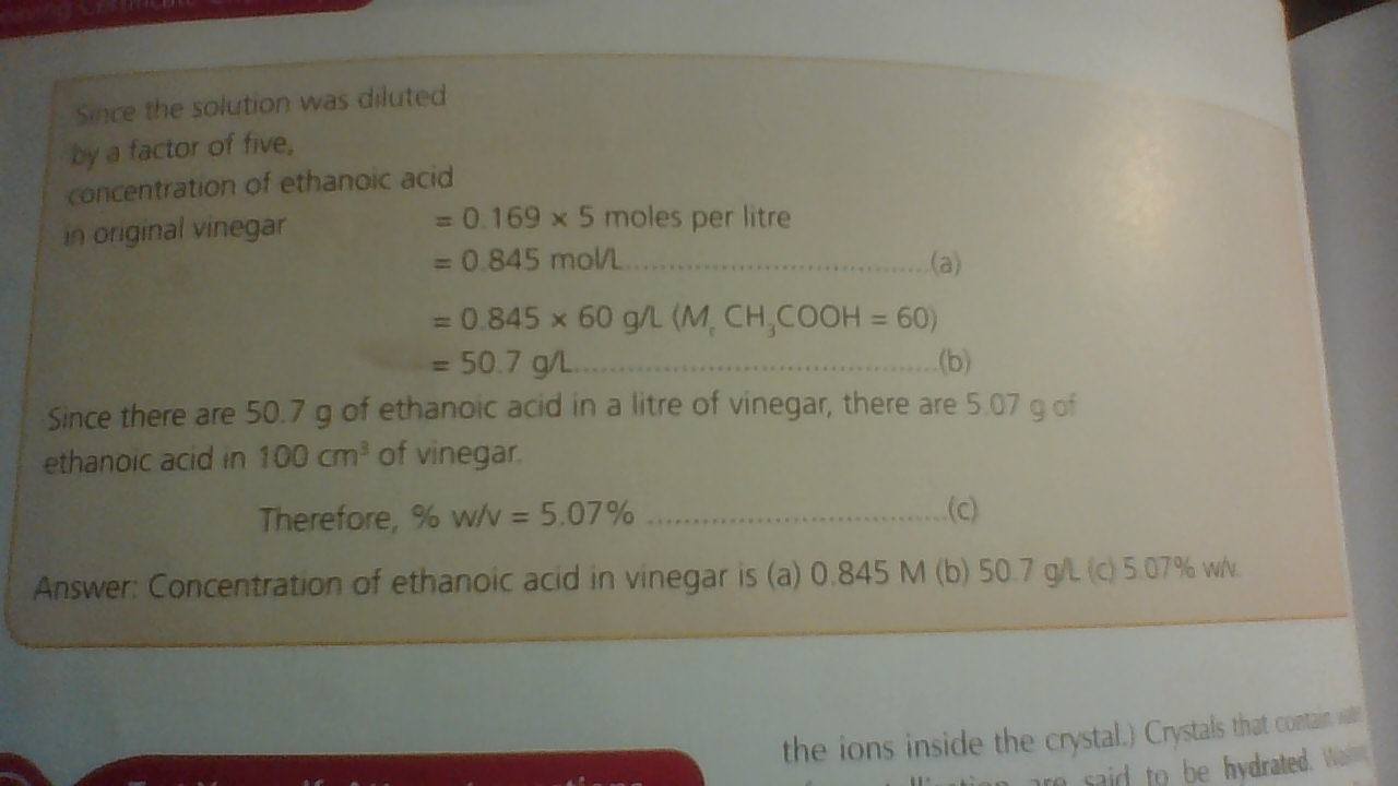

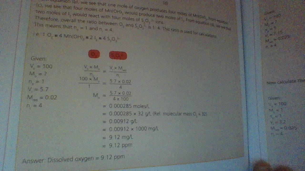

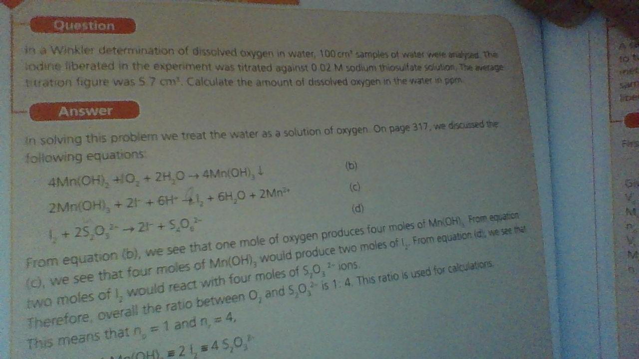

I am confused on a titration question.
View attachment 7278View attachment 7279I understand most of it but I do not see why they do not multiply their answer by 10 at the end because it says 100 cm^3 of water was analysed but that formula gives answers in moles/L so to make it into a liter they should multiply by 10 but they do not ?
The unit of $100\text{ cm}^3$ cancels against the unit of $5.7\text{ cm}^3$.
That is, we're left with the ratio between those 2 volumes, which is unit-less.
That leaves the unit of the concentration $M=0.02\text{ g/L}$ (I can't read the subscript), which is already in $\text{g/L}$.

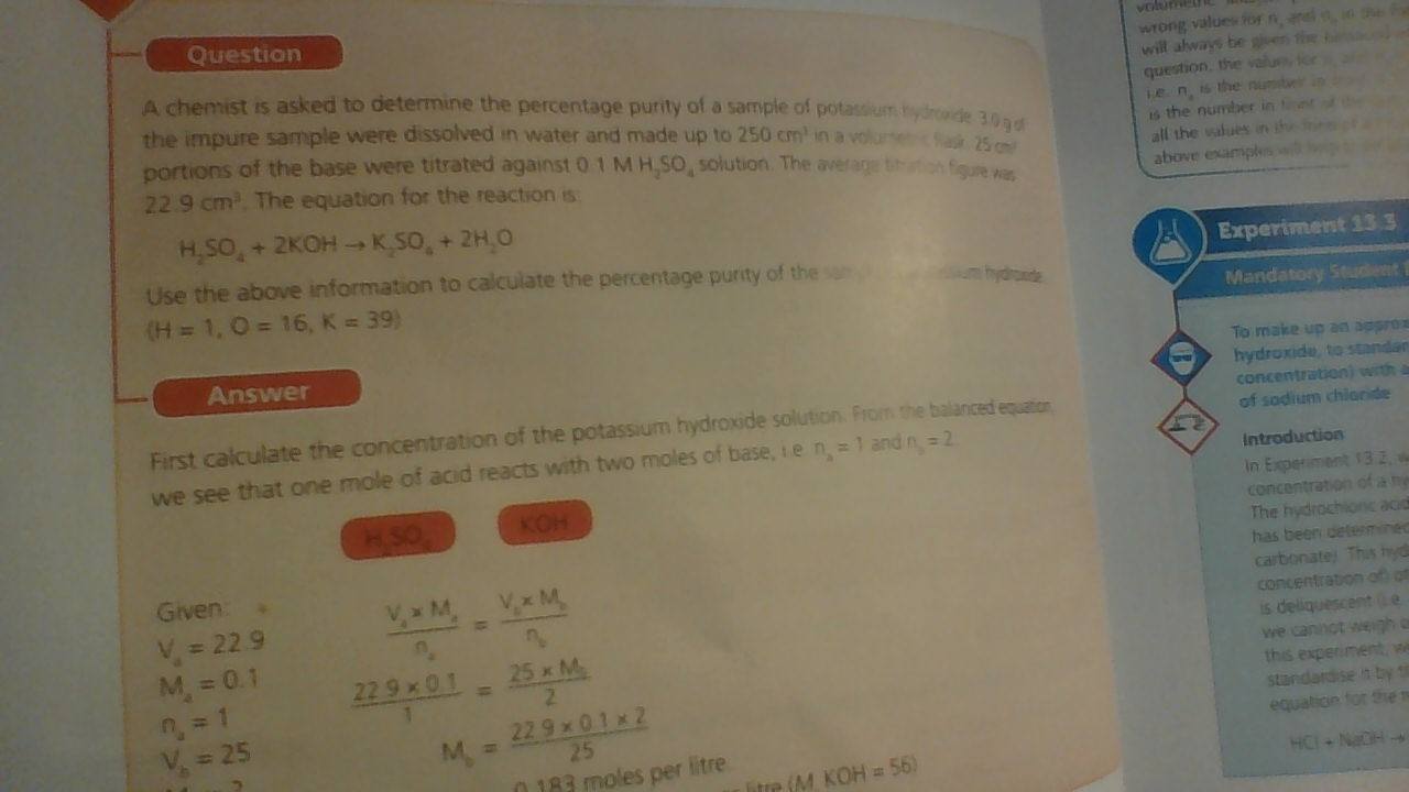

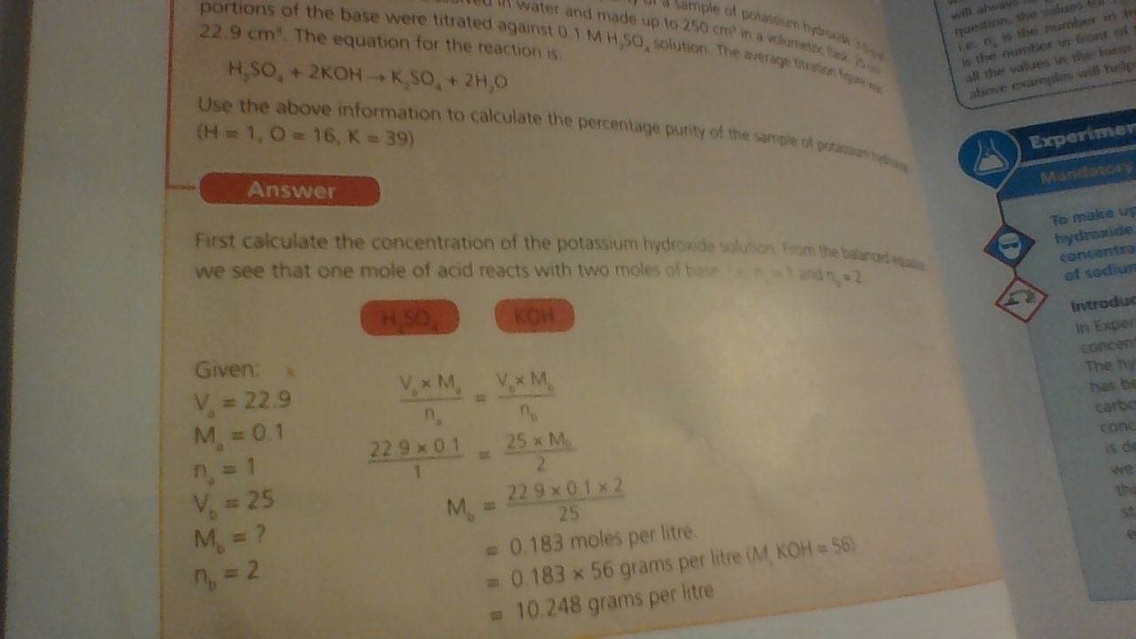

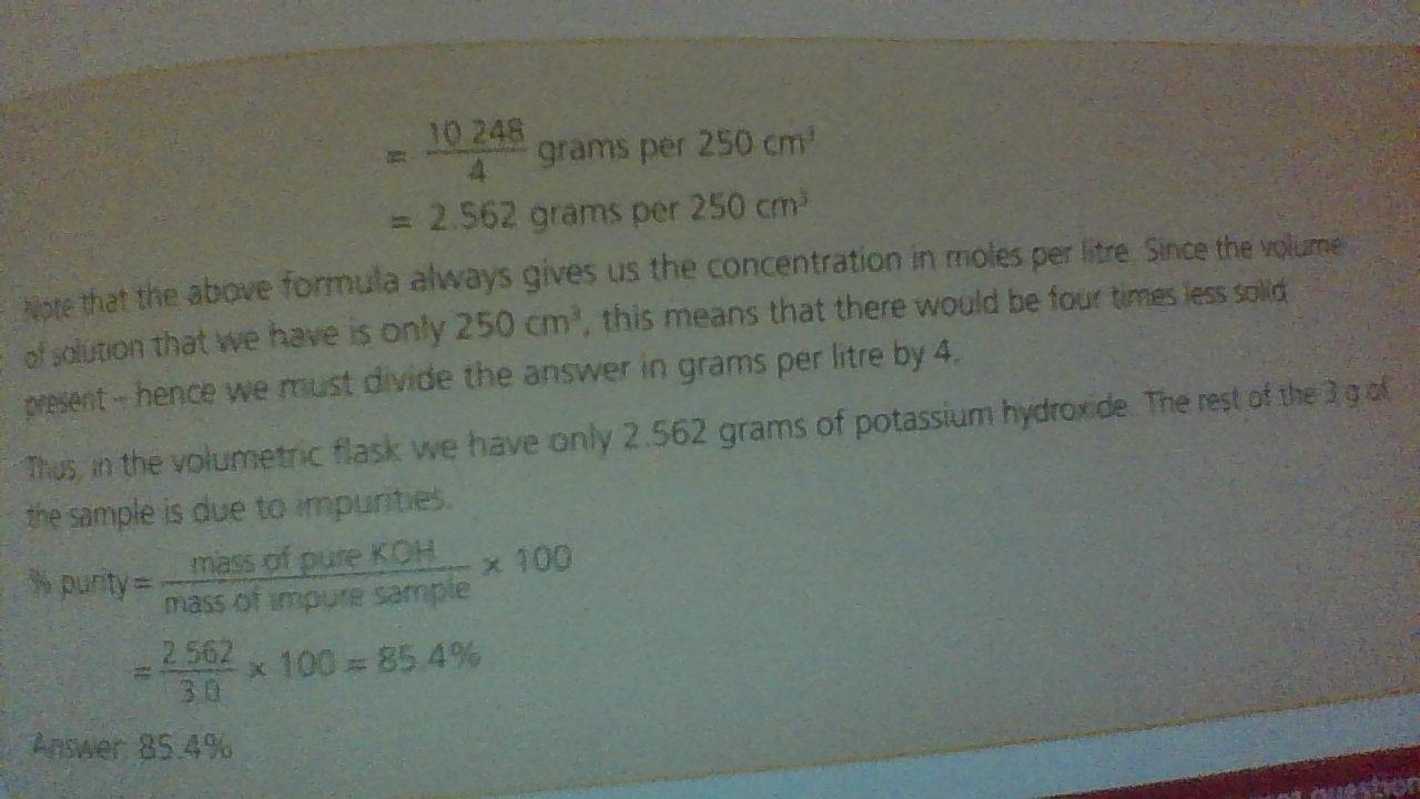

i am confused on this question though.
here they divide their answer by 4 at the end even though both units are in cm^3
- - - Updated - - -
i also do not understand this question. i understand that they multiply at the end by 5 as there was a dilution factor of 5 but I do not see why they do not divide by 10 as the vinegar was in a 100 cm^3 volumetric flask .View attachment 7283

markosheehan said:
ok. thanks . i think i get it.
The given concentration is in $\text{g/L}$.
That is, the number of grams that would be in 1 liter.
Since we're talking about $250\text{ cm}^3$, which is a quarter of a liter, we need to divide by 4.
Again, the concentration is given in $\text{g/L}$, which is the number of grams that 1 liter would have.
And it's not the number of grams in the original flask - that would be 1/10th.
in the vinegar titration they ask for the the concentration of the ethanoic acid in the original vinegar so if you get your answer in grams per liter. so would be not have to take into this consideration by dividing by 10 to find the amount of grams in the original solution.
Only if they would have asked for the 'grams' (the mass).
But they're asking for the 'concentration'. For concentration the volume is irrelevant - it has been 'divided out'.
So whether we have 1 liter with 60 g/L, or we have 0.1 liter with 60 g/L, they have the same concentration of 60 g/L.
Of course there are 60 grams in that liter, and only 6 grams in the 0.1 liter.
Thanks . Ok so only divide when you are dealing with grams of a substance in a solution to find out the number of grams in that amount of solution.
