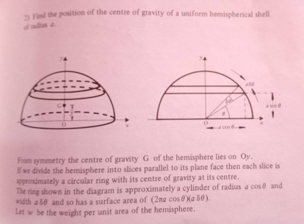

Prior to this question there is an example of a similar question:
And here is the answer:
So, to solve my question I propose to solve the same integral but instead of the limits being $$0\,\,to\,\,\frac{\pi}{2}$$ I will use $$arcsin(b/a)\,\,to\,\,\frac{\pi}{2}$$
And for the area of the whole cap I will use the formula $$Area_{cap} = \pi(h^2+a^2)$$ where h is the height of the cap, so in my case h = a - b and so I have $$A_{cap} =\pi((a-b)^2+a^2)$$

You can easily see that your answer must be wrong as the limit when ##b \to a## should be ##a##.
Where did you get the expression for the cap area? It does not seem correct as it is non-zero when ##h \to 0##.
Thanks very much. Yep, the formula for the surface area is wrong. I got it from https://mathworld.wolfram.com/SphericalCap.html. I may have misinterpreted it. I should have noticed that it didn't tend to zero as h tended to zero. Thanks for seeing that. I used instead a different version of the formula from the same page and it checks out in Wolfram Alpha, will derive by hand now.
$$Area_{cap} = 2\,\pi\,r\,h$$
Thanks,
Mitch.
I see that I did misinterpret the first version of the formula. The a in that version is the radius of the base of the cap , not the radius of the whole sphere.
So with that, are you now able to find the correct expression?
Yes, I am. Thanks very much.
