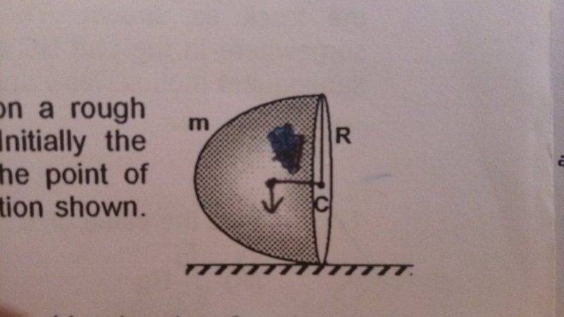

A hemispherical bowl of mass m and radius R is placed on a rough horizontal surface. Initially the centre C of the bowl is vertically above the point of contact with the ground(see figure).
Now the bowl is released from rest. Find the normal force acting on the hemisphere initially if the coefficient of static friction is 1/2 of that required to prevent initial slipping of the bowl.

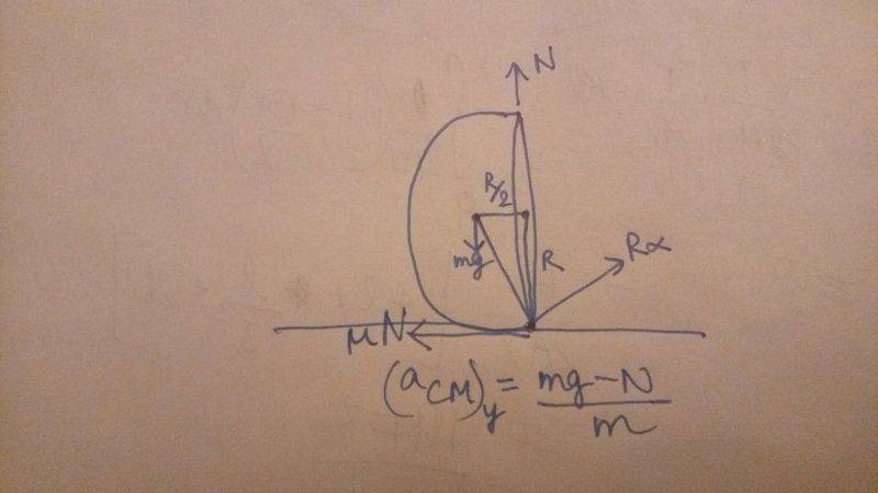

a =R(w), w= angular acceleration
Centre of mass of hollow hemisphere = R/2 distance from centre
Max = nN (n = coeff. Of friction)
Mg - N = May
MgR/2 = 5/3MR^2 (w) ...Torque about lowermost pt
w = 3g/10R
I already figured out the minimum coefficient of friction for no slipping to be 6/17. This matches with the solution. But I am unable to find the normal force corresponding to half of this value(3/17).
I have 2 equations relating horizontal and vertical accelerations of the CM to N and Mg (above) but this is not enough as I need another to eliminate variables.

This gives N = 17mg/20 as nothing has changed from when there was no slipping. So what am I doing wrong?
Let's see your free body diagram.

FBD attached
I have doubts regarding this equation. These all should be carefully written from the theorems of dynamics
Oh, I think i found a possible error - am I not allowed to apply torque = I*alpha about that point as it is a noninertial frame which is not the instantaneous axis of rotation or the centre of mass
Ok yes that was the error. I solved it taking torque about the center of mass and got the correct value of alpha. Then I got the right answer(N = 85mg/118).
Thanks for the help
