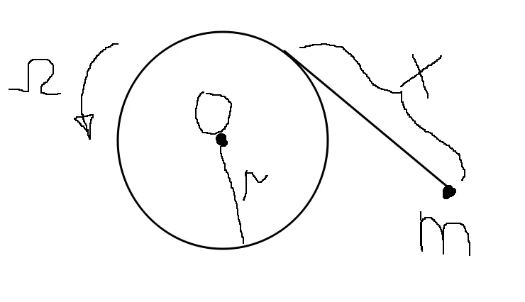

A disk of radius ##r## is wrapped with an inextensible massless string. A particle of mass ##m## is attached to the end of the string. The disk rotates about its center ##O## with angular velocity ##\Omega=const##. The whole system is placed on a smooth horizontal table.
This is a Lagrangian system with one degree of freedom. To study this system take ##x,\quad x>0## the length of the free tail of the string as a generalized coordinate.
It is easy to calculate the Lagrangian
$$L=\frac{1}{2}\frac{m}{r^2}x^2\dot x^2+\frac{1}{2}m\Omega^2x^2.$$
The Lagrange equation has a singularity at ##x=0## . To get rid of this problem introduce a new variable ##\xi=x^2.## The Lagrangian takes the form
$$L=\frac{1}{8}\frac{m}{r^2}\dot \xi^2+\frac{1}{2}m\Omega^2\xi.$$
To understand the dynamics it is convenient to draw a phase portrait that is to draw a set of level lines of the generalized energy integral $$H=\frac{1}{8}\frac{m}{r^2}\dot \xi^2-\frac{1}{2}m\Omega^2\xi$$ in the plane ##(\xi,\dot \xi)##.
It is interesting to note that the system has solutions that first wind up on the coil and then wind off the coil; the particle does not touch the coil.
Also there are solutions ##x(t)## such that ##\dot x\to-\infty## as ##x\to 0##.

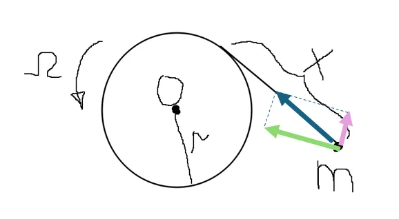

Does the wire wrapping direction wrt ##\Omega## matter in your result ? It seems that one tighten and the other loosen the wire.
For intuition it is convenient to consider the wrapping direction as it is shown at the picture and to assume that the string remains tighten. I have written formulas in such an assumption. Anyway all these words just describe an ideal constraint we use.
I see.
Tension from the wire (blue) generates centripetal force (green) for circulation of m. The rest component (purple) causes unwrapping the wire. Thus x increases with time.
Am I correct ?
it seems yes
Thanks.
For x/r ##\rightarrow \infty##, the purple force decreases so ##\dot{x}## would also decrease.
For x=0 wire tension cannot generate centripetal force. The singularity would come from it.
For x=+0 wire tension is +##\infty## thus the purple force is also +##\infty## which would cause infinite ##\dot{x}##.
Actually we do not know how the centripetal force is directed. To understand that one must know the trajectory first.

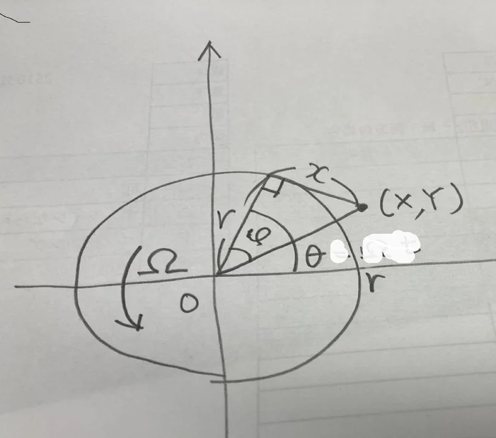

I try to make the Lagrangian. Say coordinate of m is (X,Y)
$$X=r \sec \phi \ \cos (\theta - \phi) $$
$$Y=r \sec \phi \ \ sin (\theta - \phi) $$
where
$$\theta = \Omega t + \frac{x}{r} + \theta_0-\frac{x_0}{r} ; \theta_0=0$$
$$\phi = \tan^{-1}\frac{x}{r}$$
Lagrangian is made of kinetic energy caluculated by these, i.e.
$$\frac{2}{m}L=A\dot{x}^2 + B\dot{x}+C$$
where
$$A=\sin^2\phi+\sec^2\phi \sin^4\phi=\frac{x^2}{r^2}$$
$$B=2r\Omega \tan^2\phi = 2\Omega \frac{x^2}{r} $$
$$C=r^2\Omega^2 \sec^2\phi=\Omega^2 (r^2+x^2)$$
Lagrange equation is
$$ 2A\ddot{x}+A'\dot{x}^2-C'=0$$
where prime means derivative by x.
$$ A'=\frac{2}{r^2}x$$
$$ C'=2\Omega^2 x$$
Introsucing scaled variables :
$$ \frac{x}{r}=\eta,\ \Omega t = \tau$$
the equation is
$$\eta(\eta \ddot{\eta}+\dot{\eta}^2-1)=0$$
Solution ##\eta=0## is not a physical one. Another soluition is
$$ \eta^2 - \eta^2_0= \tau^2 + 2\eta_0 \dot{\eta_0} \tau$$
For ##\dot{\eta_0} >0##. ##\eta## increase with time as posted #4.
For -1< ##\dot{\eta_0} <0##, ##\eta^2 - \eta^2_0 = - (\eta_0\dot{\eta_0})^2 ##, the minimum at ##\tau=-\eta_0\dot{\eta_0}##. Its decrease-minumum-increas behaviuor is in accord with the note in OP.
For ##\dot{\eta_0} < -1 ##, ##\eta## decrease to zero. The mass collide the disk so another physics process should be considered.
I have corrected mistakes. I am afraid there remains more mistakes.

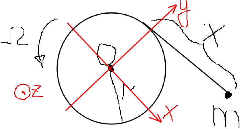

Introduce a frame ##Oxyz##. The axis ##Oy## passes through the point ##O## and the point where the string comes off the disk. The frame ##Oxyz## rotates and has the angular velocity
$$\boldsymbol \omega=(\Omega+\dot x/r)\boldsymbol e_z.$$
Kinetic energy of the system is
$$T=\frac{m}{2}|\boldsymbol v|^2,\quad \boldsymbol v=\frac{d}{dt}\boldsymbol{r}_m,$$
$$\boldsymbol{r}_m=x\boldsymbol e_x+r\boldsymbol e_y,$$
$$\boldsymbol v=\frac{d}{dt}\boldsymbol{r}_m=\dot x\boldsymbol e_x+x\boldsymbol\omega\times \boldsymbol e_x+r\boldsymbol\omega\times \boldsymbol e_y.$$
The Lagrangian is ##L=T##. Up to a total derivative we finally obtain ##L## as I wrote above.
