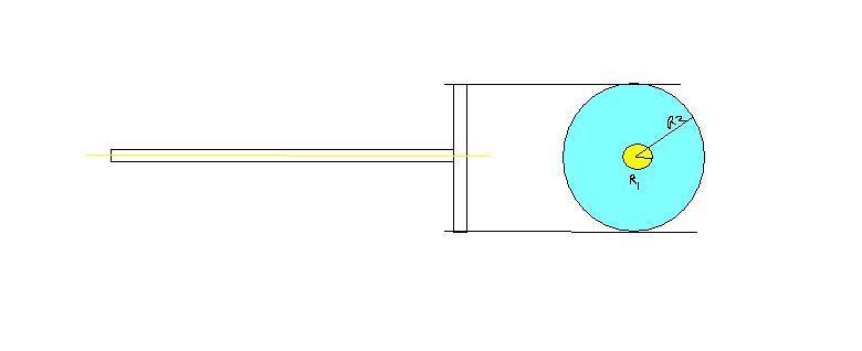

Let me put it forward in a much clear manner.
I have got actually three questions all involving the same concept.
Number1:
We have to calculate the Torque required to turn a shaft at the end of which is attatched a solid wheel of mass M and radius R, and the mass of the shaft is m and radius r.
So we are actually supplying torque to the shaft inorder to turn it ( along with the wheel being attatched at the end).
Hence in this case, it is not merely the shaft alone or the wheel alone which is under discussion. So calculating the MI for the wheel alone ignoring the shaft won't help.
Thats my question : How would we go about to calculate the MI for the Torque required when the attatched wheel and the shaft both have a mass ( M and m resp) and each with radius R and r resp. The shaft has its own mass m and also has to bear the mass of the wheel M attatched to it, so (0.5)(M)(R^2) alone or (0.5)(m)(r^2) alone won't help.
So How do we calculate the total value of Torque to turn such an arrangement?

You're questions are much clearer now.
For number 1, you just work it out normally. You have to integrate it though if you are trating it as a single unit.
To work out MOI you are treating a shaft as a 2D circle anyway, so the middle you just add the mass of the shaft and disc together for that dm. After the radius of the shaft you just use the mass of the flywheel per dm.
I don't know how to make nice sexy integration symbols.
So I=INT[from centre to shaft radius] r^2 d(m+M) + INT[shaft r to outer r] r^2 dM
Yellow bit is mass of shaft and mass of disc d(m+M), blue bit is mass of disc only.I think in this case you cal also work the MOI of the shaft and mass separately, then just add them togther.
