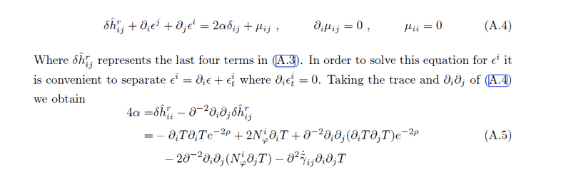

Is there anyone can give me a hand?
http://arxiv.org/abs/astro-ph/0210603
When I read this paper I can not get Eq.(A.5) from (A.4). Why it is ##4\alpha##? If we take the trace of Eq.(A.4), why not it give us ##6\alpha##?
Eq. (A.3):
[Edited by a mentor to fix a small problem in the Latex formatting]
The trace of (A.4) is
$$\delta\hat{h}^r_{ii} + 2 \partial^2 \epsilon = 6 \alpha,$$
while ##\partial_i\partial_j## gives
$$ \partial_i\partial_j \hat{h}^r_{ij} + 2 \partial^4 \epsilon = 2 \partial^2\alpha.$$
Multiplying the 2nd by ##\partial^{-2}## and subtracting gives the first line of (A.5).

Thank you fzero! Could you please give me some detail? How to get
from
And how to get the frist line of (A.5). Actually, I do not understand the "\partial^{-2}". Thank you again.
