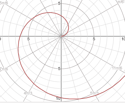

Just to simplify the shape
r = vt
theta = wt
r = v*theta/w
r = K*theta
A type of spiral.
Well, in my question and your example it's easier see the motion by take it directly, but i am confused if i tried to do it starting with the velocity.
Your example:
the minus sign because to someone in rest at the center, he doesn't route, the stone or whatever, that starts a moving this spiral.
v = v*ur ´- wr*utheta
v = v*ur - wvt*utheta
Make sense i try to integrate this? I think not, maybe is this a dead end and have to do the first approach?
