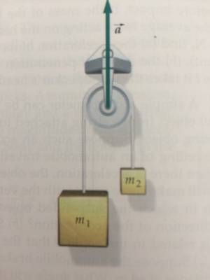

The pulley in an Atwood's machine is given an upward acceleration *a*, as shown below. Find the acceleration of each mass and the tension in the string that connects them. Hint: a constant upward acceleration has the same effect as an increase in the acceleration due to gravity
Find the acceleration of blocks 1 and 2 in both a non-inertial frame of reference (an observer accelerating with the machine) and an inertial frame of reference (observer at earth)
