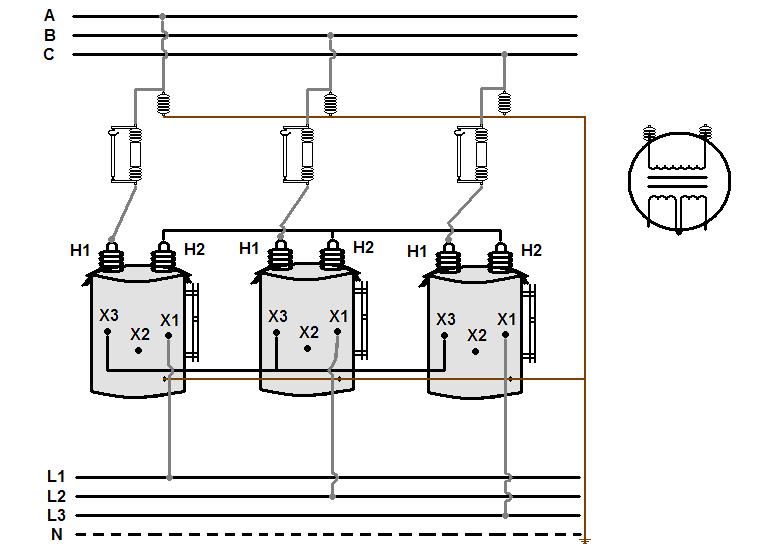

For three-phase power, three separate single-phase transformers can be used, or all three phases can be connected to a single polyphase transformer. The three primary windings are connected together and the three secondary windings are connected together. The most common connections are Y-Delta, Delta-Y, Delta-Delta and Y-Y.
http://en.wikipedia.org/wiki/Transformer_types"
I'm guessing they were using a Y-Y configuration like this:
That could be. But is that a reason to not use a single 3 phase E-core transformer? I guess if all the single E-core ones are only made as D-Y, that could be a reason. It could be cheaper to buy 3 single phase transformers instead of a custom made E-core. Are there any other technical issues where an E-core has problems, like whatever motivates a Y-Y?
Also, while looking at your diagram, another question pops up that I've wondered about. Are the single phase pole transformers which have dual 120 volt windings internally grounded on the center tap, or can they be grounded externally on one end LV bushing to make them be 240V L-N (or three of them yield 416Y/240)?
