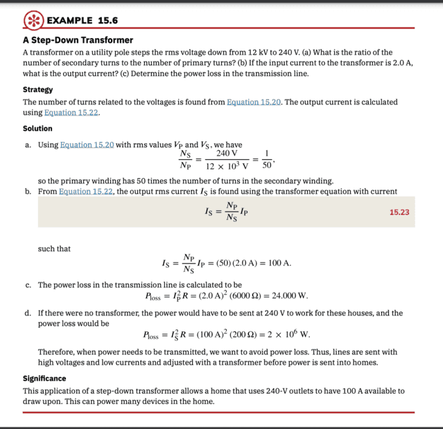

A transformer on a utility pole steps the rms down from 12kV to 240V. If the input current to the transformer is 2 A, what would the power loss have been if there were no transformer
##I_S = \frac{N_P}{N_S}I_P##
##P_{loss} = I_S^2R##
##\frac{N_S}{N_P} = \frac{240}{12\times 10^3} = \frac{1}{50}##
##I_S = \frac{N_P}{N_S}I_P = \frac{N_P}{N_S}I_P = 50\times 2 = 100## Amps
##P_{loss} = I_S^2R##, but I don't know how to find R

If you think it is poorly worded, it is the last part (part d) of this problem
The phrase "if there were no transformer, the power would be sent at 240 V to work for these houses" was omitted from your original post. It was crucial to an understanding of the situation. The entire thread was derailed because you failed to post a complete statement of the problem you wanted solved.
OK, that makes sense. I have no idea where R=6000Ω came from, maybe earlier in the text?

They are asking for the power loss in the transmission line. Not the power delivered to the load.
Mister T said:
You have 12 000 volts across the primary coil, which carries a current of 2.0 amps.
The resistance should be 200 ohms though...
@annamal, From now on, please post problem statements exactly as they are and not according to your own interpretation.
Because these two are not necessarily the same, for example here, the problem asks for the power loss in the transmission line while you asked for the power loss in the transformer, and the phrase "if there were no transformer" is accompanied by "and the power would be sent at 240V to homes" which is critical for our understanding.
I guess the book implies here that when the power is sent directly @ 240V to house, then the power loss in the transmission line is still much bigger even if we shortened the length of the transmission line (hence its resistance drops from 6000 to 200 Ohm). Or I can't make any other usefull interpretation.
The solution given to part c is clearly nonsense. There is not enough info to determine an answer. The calculated 24,000W is the power consumed by the transformer plus load, i.e. everything except the transmission line.

Parts C and D are a bit hard to understand in my humble opinion.
In part C, 6000 ohms seems to be the ohmic resistance of the transmission line, but it is strange why this value is exactly equal to the input impedance ##~\frac {12kV}{2A} ~##of the transformer ?
In addition, part D does not explain how the value of 200 ohms is obtained. This is not the ohmic resistance of the transmission line in part C, nor the ohmic resistance inside the transformer. It is really difficult to guess what it is. :confused:

It's really not so much about your formulas R=V/I or P=I2R, we all know those. It's all about which voltage, what resistance and where did it come from.
The key phrase here is "power loss" There is no reasonable interpretation of this problem that would mix that up with the power sourced or delivered to the load. If you can't see that distinction, perhaps you should be asking questions instead of providing solutions. The options are simple in this case:
1) There isn't the necessary information given to answer this question. We can't know who is responsible, we just know that it isn't there.
2) The line resistance is given as 6000Ω, or 200Ω in a subtle manner with no explanation about why.

You are missing the point. We have no information regarding the ohmic resistance of the transmission line. The ##6000\Omega## calculated appears to be the effective resistance of the transformer + downstream load.
ok, fine if that's your point I agree.
Perhaps we were meant to be given 200 Ohms as the transmission line resistance (still high, but at least feasible) and the part c solution should have used that value too.
