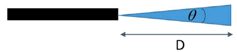

A laser emits radiation of wavelength ##\lambda= 632.8 nm## and a power of ##3 mW## and its beam has an angular divergence equal to ##180 \mu rad##. What is the intensity of the laser beam at a distance of ##D = 5 m##?
What would be the power of an isotropic source that provided the same intensity at the same distance?
##\theta=\frac{2R}{D}##, ##I=\frac{P}{4\pi d^2}##
I haven't been able to pinpoint a definition of "angular divergence" of a laser so by pure intuition I assumed it would be something like ##\theta=\frac{2R}{D}## and with that I have that the radius of the lase beam is ##R=\frac{D\theta}{2}=90\cdot 5 \cdot 10^{-6} m=450\ \mu m## so ##I_{5m}=\frac{P}{4\pi R^2}=\frac{3\cdot 10^{-3}}{4\pi \cdot 450^2 \cdot 10^{-12}}\simeq 1179\ \frac{Watt}{m^{2}}## and so I get for an isotropic source ##P_{iso}=I_{5m}\cdot 4\pi D^2=1179\cdot 4\pi 5^2 Watt=370391 Watt##. Now, I am suspicious of these results since I never had to use the wavelength \lambda so I think my definition of angular divergence is wrong; could anyone shed some light on this definition and how to apply it in this case? Thank you very much.

Hi,
A simple google would have shown your intuition is almost OK...
And checking your math is always a good idea $$R=\frac{D\theta}{2}=90\cdot 5 \cdot 10^{-6} \ {\sf m}=450\ {\sf nm}\quad ?$$
Checking dimensions is always a good idea too $$I=\frac{I}{4\pi D^2}=\frac{3\cdot 10^{-3}}{4\pi 5^2}\ {\sf W}\simeq 9.6\cdot 10^{-6}\ {\sf W}\qquad ?$$

What I meant by "I haven't been able to pinpoint a definition" is that I found several definitions and since I didn't know the correct one to use in this case I went with the one that intuitively made the most sense.
Still, I don't understand why the problem gives ##\lambda## if it is of no use in the solution.

I don't understand this calculation. You seem to have found the intensity (##Wm^{-2}##, not ##W##) that would have been obtained with the same power source had it been isotropic. That is not what you are asked to find.
In such a case, (i.e. if your notes or textbook don't provide one) you state the definition and work with that, as you did. If I were to grade it (and notes or textbook indeed don't provide one), I wouldn't subtract points.
And the first hit (gentec) agrees with your intution, so my 'almost' was in error !
Now on to $$I_{5m}=\frac{P}{4\pi R^2}$$This is for an isotropic source. But not for your laser!

That R is not the distance from the source. D is used for that here.
I don't know the formula for the non-isotropic case so I thought I could modify that one and use as radius the one I got from the angular divergence.

The item on Gaussian laser beams at https://en.m.wikipedia.org/wiki/Beam_divergence shows how the wavelength can be relevant, but since you are not given the aperture at source it does not seem relevant here.
That is exactly what I thought too.

Doesn’t seem quite right. It has to illuminate an area ##4\pi D^2## instead of ##\frac 14\pi(D\theta)^2##. So I get ##3mW*\frac{16}{\theta^2}##, which is about 1.5MW.
@lorenz0 : you grasp this factor 4 now ?
Final note: when you get input of 1 or 2 digit accuracy, don't provide a result wih 6 digits.
