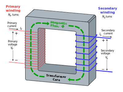

This was in my test paper today:
A transformer is cut into half so that one half contains the primary coil and the other half contains the secondary coil. They are moved 30cm apart. Explain why the transformer would not work
My answer: The magnetic field strength will be very weak so it would induce negligible emf in the coil.
Then my teacher gave me zero marks and said this is wrong.
His answer: The field lines will not reach the secondary coil. Therefore,not magnetic field lines are cut and emf is not induced.
I thought what the $%^&?
I think what he said is wrong. The magnetic field lines will reach any distance.
How is my answer wrong?

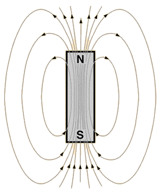

The B-field of the half coil will be be like that of a bar magnet.
Some field lines reach the secondary coil,
but that field is very week to produce appreciable induced voltage. You were right but you should have emphasized that the field in the secondary coil would be very weak.
Now think of the working principle of the transformer. Primary and secondary coil share a common iron core.
Almost the whole flux produced in the primary coil appears in the secondary one. The loss is small, the output power is close to the input. That can not be said about the halved coil. It is not a transformer any more.

If you put it 30cm away and the transformer is not working, that means the magnetic field is weak. "Field lines will not pass through the secondary coil" does not make much sense to me because magnetic field follows the inverse square law which states that the intensity of the magnetic field will decrease with the square of the distance. That means as x approaches infinity, the magnetic field strength will approach zero. But it's not possible to reach infinity, right?
It would be better to say far fewer field lines will now pass through the secondary coil, rather than none.
