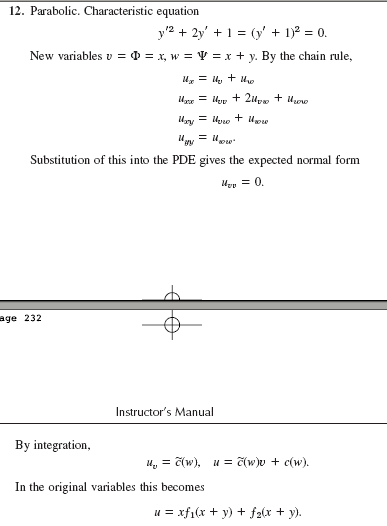

The problem is to transform the PDE to normal form.
The PDE in question is parabolic: U_{xx} - 2U_{xy} + U_{yy} = 0 but I also need to solve other problems for hyperbolic pde's so general advice would be appreciated.
The characteristic equation is: Ay'^{2} - 2By' + C = 0
The new variables should be v=x, w=psi, and the normal form is U_{ww}=F_{2}
The solutions manual provides:
I get lost right after we solve the characteristic equation. I don't understand how the variable substitution works or what is going on after that. My textbook only offers 1 example similar to this problem with no explanation of how it goes from step to step...so I'm completely lost. I looked online for information but the limited amount of stuff I did find is too technical(I read through all of them).

Here's how I would do it (finding the characteristic equation slightly differently):
From U_{xx}- 2U_{xy}+ U_{yy}= 0 we get x2- 2xy+ y2= (x- y)2= 0 which has only x-y= 0 or x= y as solution. Perpendicular to that line is the "characteristic curve" (line in this case) x+y= 0. We change coordinate systems so that line is one of the axes: let v= x+ y. Since that is the only characteristic line, just let u= x be the other. In these new variables, by the chain rule,
U_x= U_u\frac{\partial u}{\partial x}+ U_v\frac{\partial v}{\partial x}
Since \partial u/\partial x= 1 and \partial v/\partial x= 1 that is
U_x= U_u+ U_v
U_y= U_u\frac{\partial u}{\partial y}+ U_v\frac{\partial v}{\partial y}
Since \partial u/\partial y= 0 and \partial v/\partial y= 1 that is
U_y= U_v[/itex]<br /> <br /> Continuing to use the chain rule,<br /> U_{xx}= (U_x)_x= (U_u+ U_v)_x= (U_{uu}\frac{\partial u}{\partial x}+ U_{uv}\frac{\partial v}{\partial x})+ (U_{vu}\frac{\partial u}{\partial x}+ U_{vv}\frac{\partial v}{\partial x})<br /> = U_{uu}+ 2U_{uv}+ U_{vv}<br /> <br /> U_{xy}= (U_x)_y= (U_u+ U_v)_y= (U_{uu}\frac{\partial u}{\partial y}+ U_{uv}\frac{\partial v}{\partial y})+ (U_{vu}\frac{\partial u}{\partial y}+ U_{vv}\frac{\partial v}{\partial y})<br /> = U_{uv}+ U_{vv}<br /> <br /> U_{yy}= (U_y)_y= (U_u+ U_v)_y= (U_{uu}\frac{\partial u}{\partial y}+ U_{uv}\frac{\partial v}{\partial y})+ (U_{vu}\frac{\partial u}{\partial y}+ U_{vv}\frac{\partial v}{\partial y})<br /> = U_{vv}<br /> <br /> Putting those into the equation U_{xx}- 2U_{xy}+ U_{yy}= 0 we get<br /> (U_{uu}+ 2U_{uv}+ U_{vv})-2(U_{uv}+ U_{vv})+ U_{vv}= U_{uu}= 0<br /> the &quot;normal&quot; form.<br /> <br /> Saying that U_{uu}= (U_u)_u= 0 means that U_u is a &quot;constant&quot; with respect to u. It must depend only on v: U_u= F(v). Integrating with respect to u again, U(u,v)= F(v)u+ G(v) where G(v) is the &quot;constant&quot; of itegration- since we are only integrating with respect to u, G may depend upon v. That is the general solution to the differential equation in terms of u and v. Since u= x and v= x+y, that is the same as U(x,y)= F(x+y)x+ G(x+y). Since F and G, above, were arbitrary functions of <b>one</b> variable, I can choose any such functions and replace the one variable with x+ y. For example, suppose F(x)= x<sup>2</sup> and G(x)= sin(x) (chosen pretty much arbitrarily). Then U(x,y)= (x+y)<sup>2</sup>x+ sin(x+ y)= x<sup>3</sup>+ 2x<sup>2</sup>y+ xy<sup>2</sup>+ sin(x+y). I&#039;ll leave it to you to show that this function does, in fact, satisfy the original differential equation.
