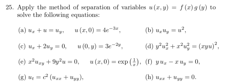

  • Printed exercise 25 asking to apply separation of variables to solve eight PDEs: (a) u_x + u = u_y with u(x,0)=4e^(-3x); (b) u_x u_y = u^2; (c) u_x + 2u_y = 0 with u(0,y)=3e^(-2y); (d) y^2 u_x^2 + x^2 u_y^2 = (xyu)^2; (e) x^2 u_xy + 9y^2 u = 0 with u(x,0)=exp(1/x); (f) y u_x - x u_y = 0; (g) u_t = c^2 (u_xx + u_yy); (h) u_xx + u_yy = 0.

Yeah, they managed to confuse you (on purpose?) writing ##u(x,y)=f(x)g(y)## instead of ##u(p,q)=f(p)g(q)## or something less suggestive...
Your post #8 explains why. (and post#7 IS exercise 25 (h) ! )
