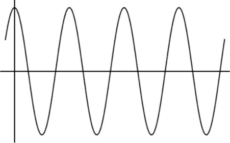

If you take a snapshot of a wave at time t = 0, it will look something like this
Is it a sine or cosine? It's neither and is called a "sinusoid" which could be either a sine or a cosine. If you were to take a second snapshot one period (or two or three) later, the picture would look exactly the same. If you were to take a snapshot half a period later, the picture would look upside down (the negative) from this.
Taniaz said:
And when is it A sin (wt-kx)?

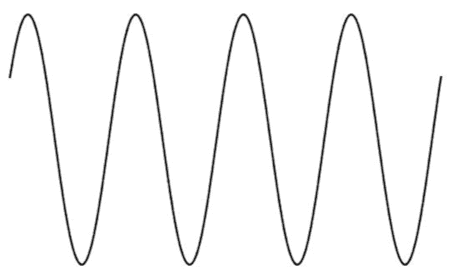

It depends on when I choose my time t = 0 axis to be. Here is the same sinusoid chosen to be a sine
And here is the same sinusoid chosen to be a cosine
